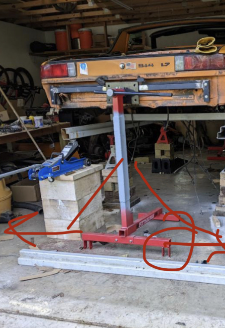

You’ve got a recipe for disaster brewing here. Thank god you’ve got other braces holding it. While those braces are holding it. Extend the base as Mark suggests. The aspect ratio between height and center of gravity height to base width is too small.
Triangulate
And get rid of the tabs that previously held the wheels. Get that base securely in contact with the ground. If those tabs fold over, the whole thing may shift and tip over.
Be safe ! No restoration project is worth dying over.
