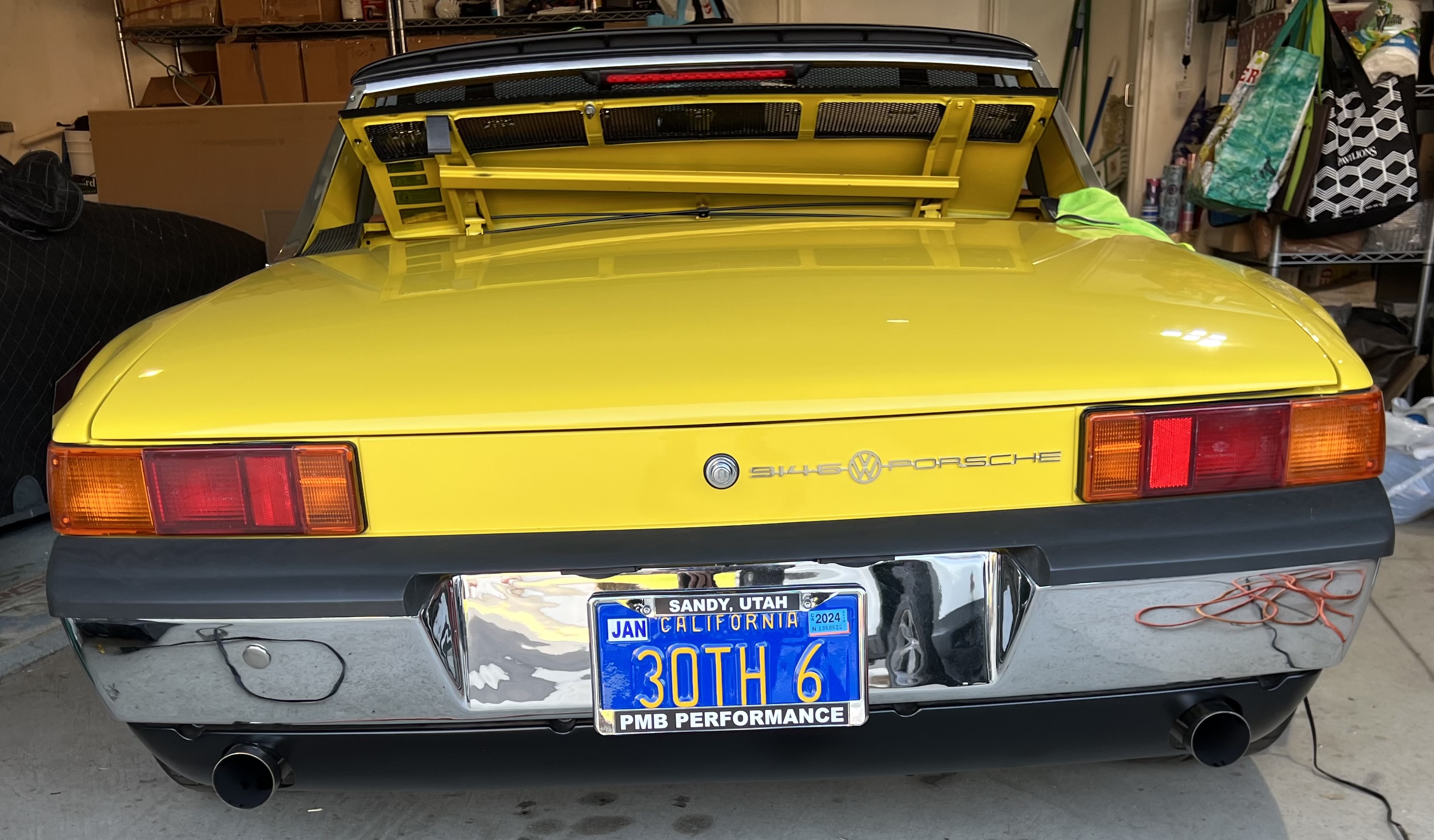

Would this be mounted on the targa bar behind the rear window?
burton73
post May 3 2023, 12:11 PM
Senior member, and old dude
Posts: 4,089
Joined: 2-January 07
From: Los Angeles
Member No.: 7,414
QUOTE(Root_Werks @ Mar 23 2023, 10:09 AM) *
I had PMB put this one in for me. Does not mess with my view and it is as high as it can go
Bob BAttached Image
