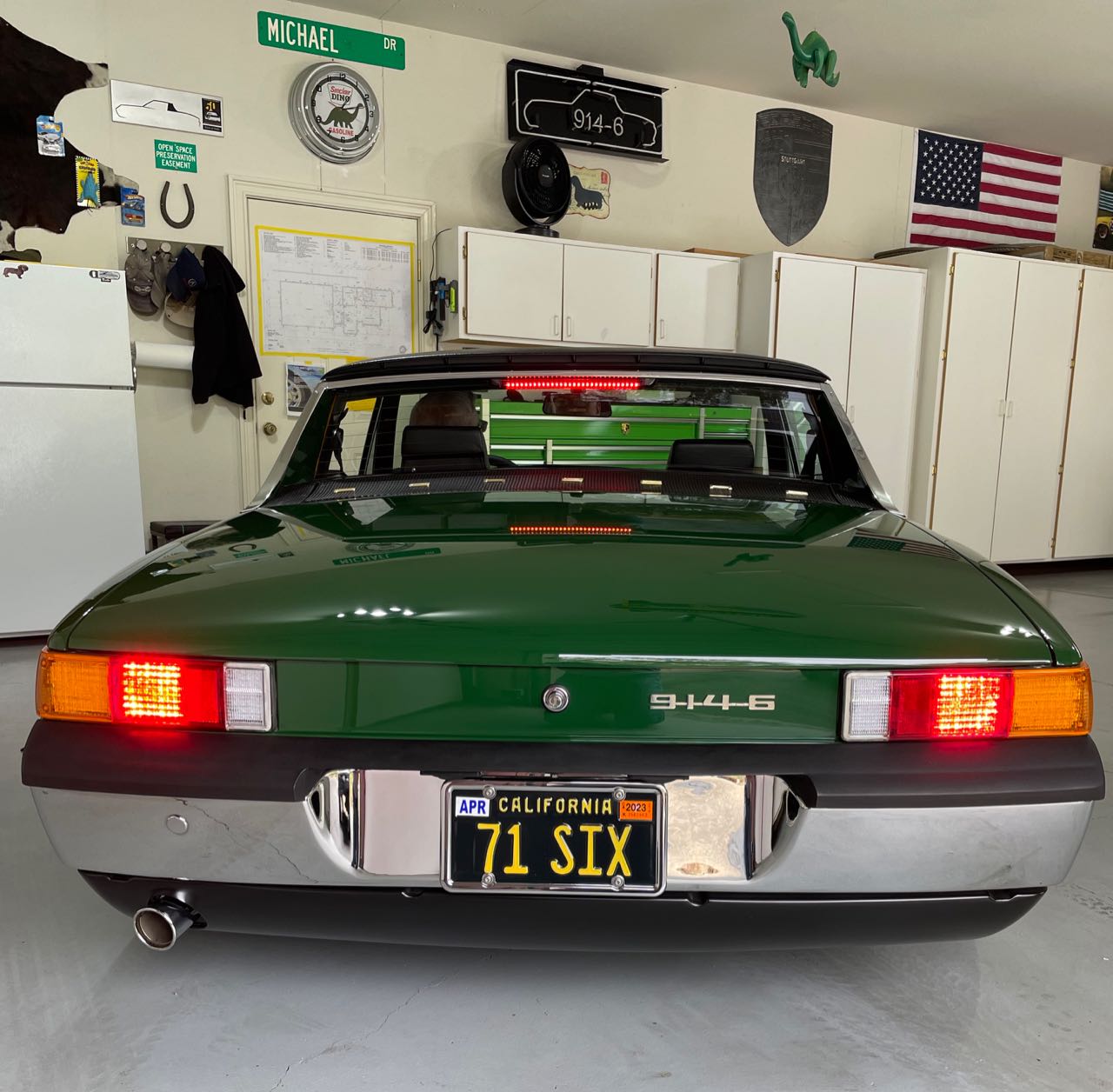

I followed Bob's lead and installed an LED 3rd brake light right under the roll-bar hoop. I do not see it when looking out the rear view mirror and it is as high up as you can get it. It really catches your attention when you step on the brakes. (PS -that's a reflection on the trunk lid, not another light. (IMG:style_emoticons/default/smile.gif))
OK, small Public Service Announcement: My personal opinion, as small and low as our cars are, this hi-mount LED 3rd brake light is a modification every 914 owner should move to the top of their list. Additionally, @Spoke (Jerry) makes the absolute best LED conversion kits for all of our lights. Truly plug 'n play and they just work. Wake up your lights so people will see your car before it is too late. Way too many distracted drivers on the roads now. (IMG:style_emoticons/default/beerchug.gif)
