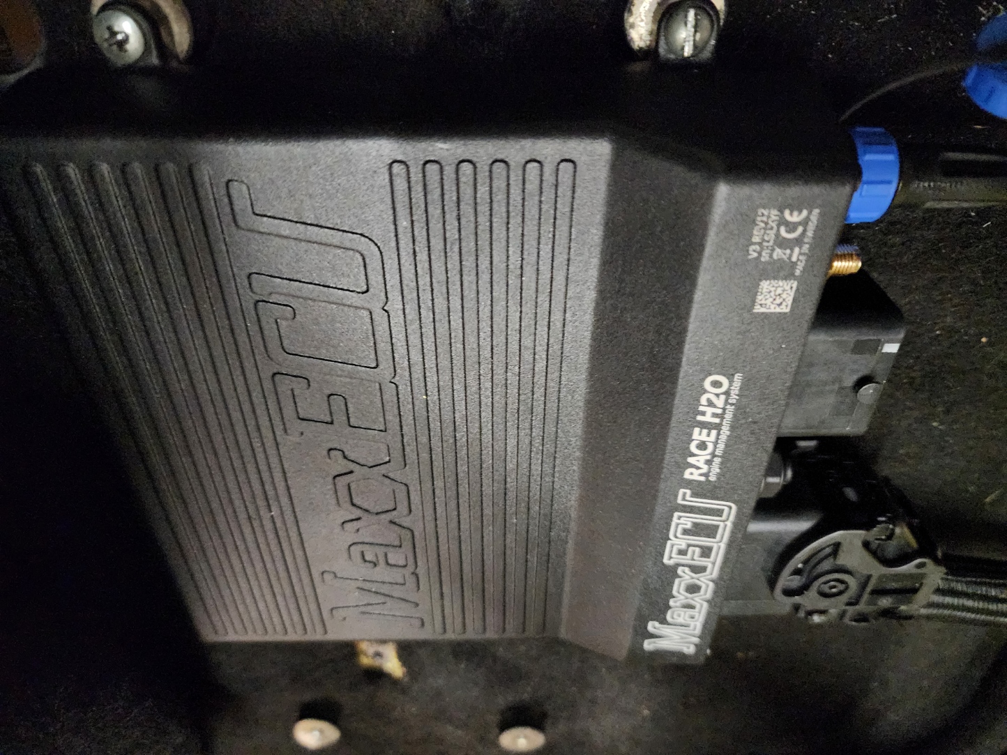

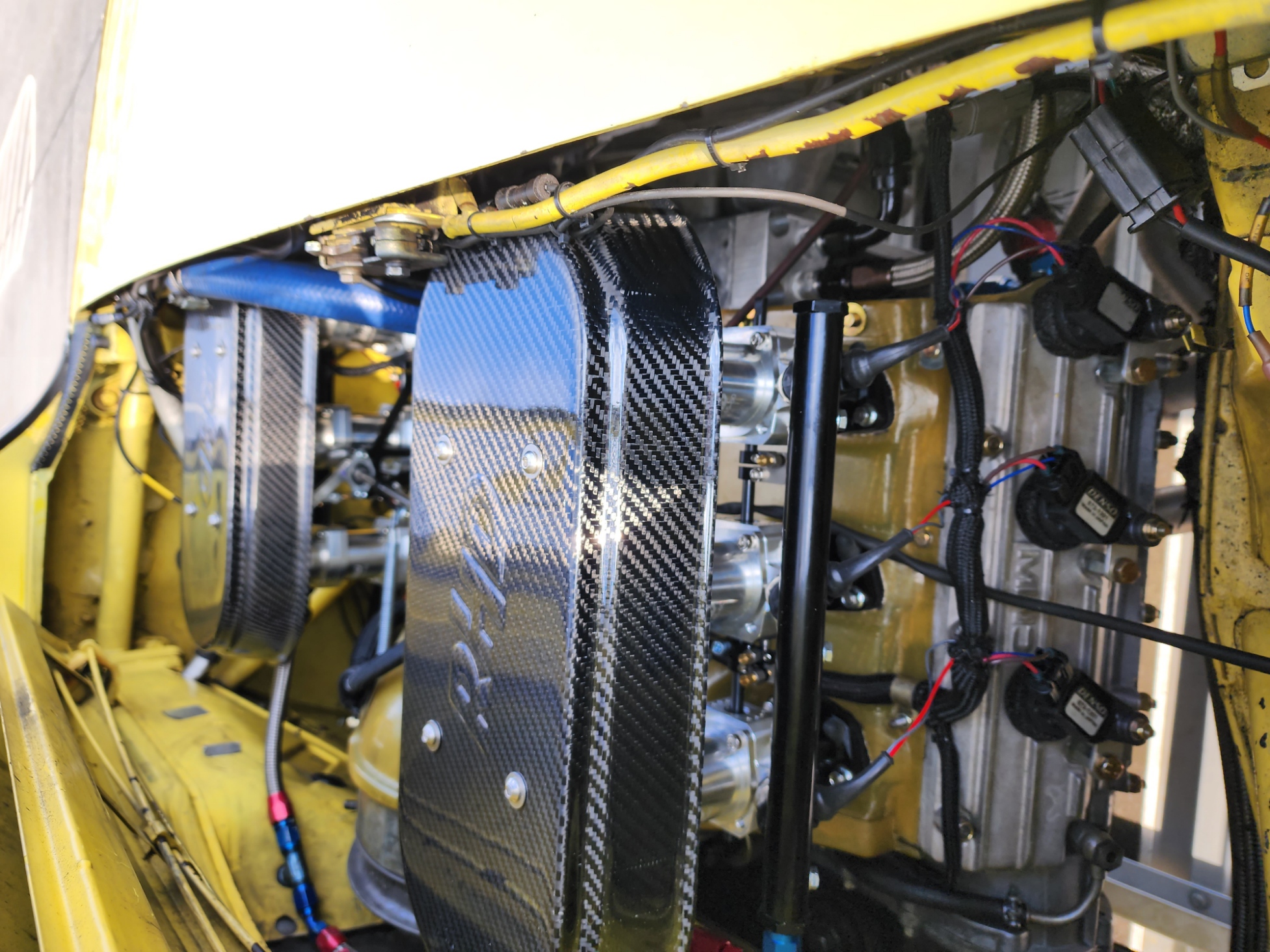

I thought folks here might like this. I posted the photos on FB too. This is my 3.0 liter that got a MaxxECU this winter along with Racehead ITB. It came out great. It's very odd to just reach in, fiip the ignition switch, and hit the starter. It settles into a nice idle right away!
I had a blast at Summit Point last weekend shaking things down. Some more tuning and it's going to be even quicker. The power comes in strong about 4,800 RPM and it screams up to 7,500!
The car has a 3.0, Wossner Pistons about 9.8:1 (IIRC), Web Cam, 915 trans with the shifter from Martin (it's awesome!), Rennshifter, custom Bilstein shocks, Boxster Brakes, and a host of other things.

I thought about the MS3, but the Maxx has a lot of power and configurability. Eventually I want to do drive-by-wire, flex fuel maps, and a few other things. This is full sequential now and I'll hopefully get to do some individual cylinder tuning. Al has done a lot of kits, so I'm sure you'll be happy.
The ECU is on the firewall behind where the passenger seat would be (I don't have one).
