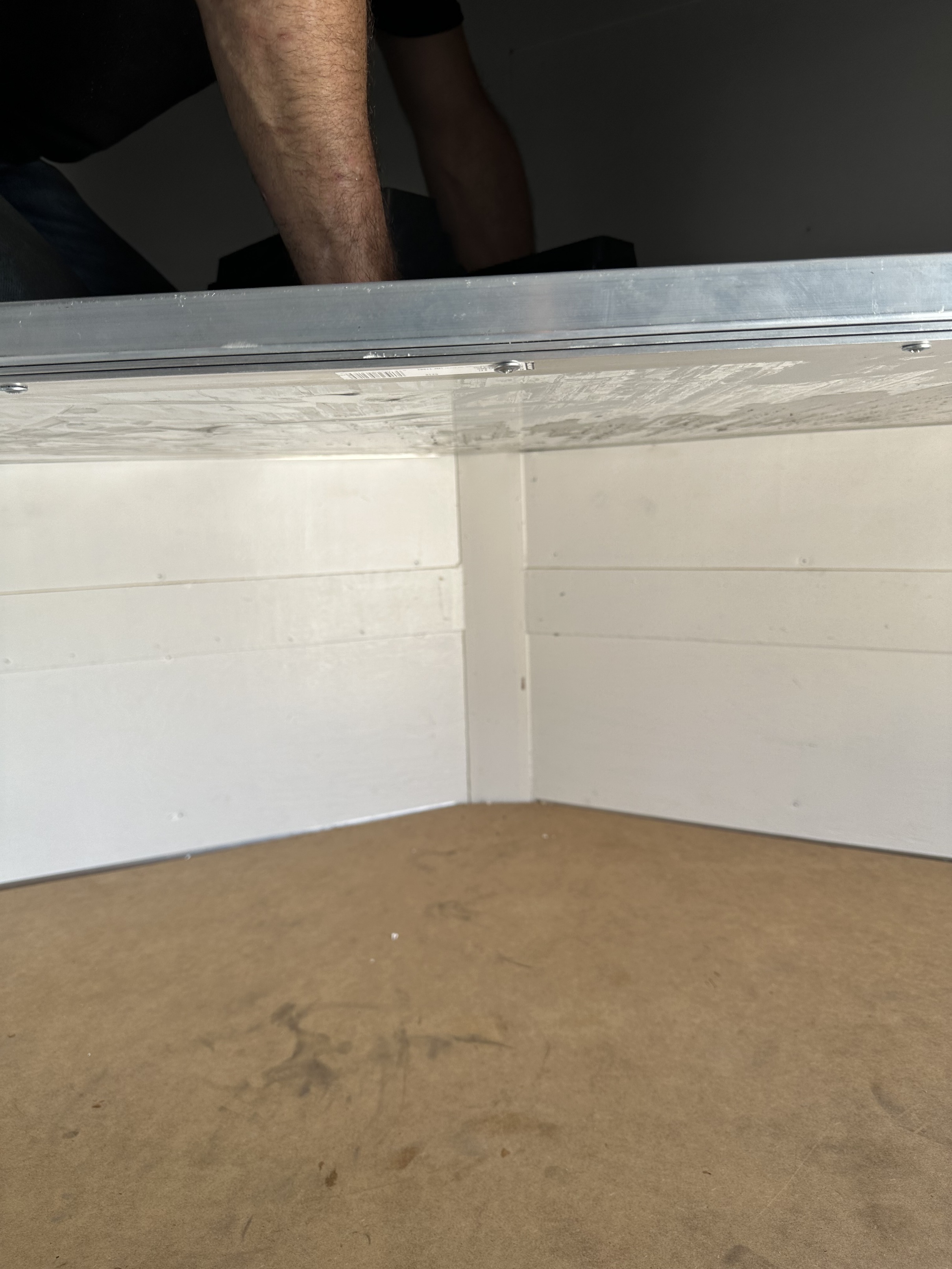

Walls are now painted and as you can see the floors already look trashed.

Got the upper cabinet floor installed. 1/4 inch aluminum and it is strong!

BillJ   Got the upper cabinet floor installed. 1/4 inch a...   May 8 2023, 06:12 PM
