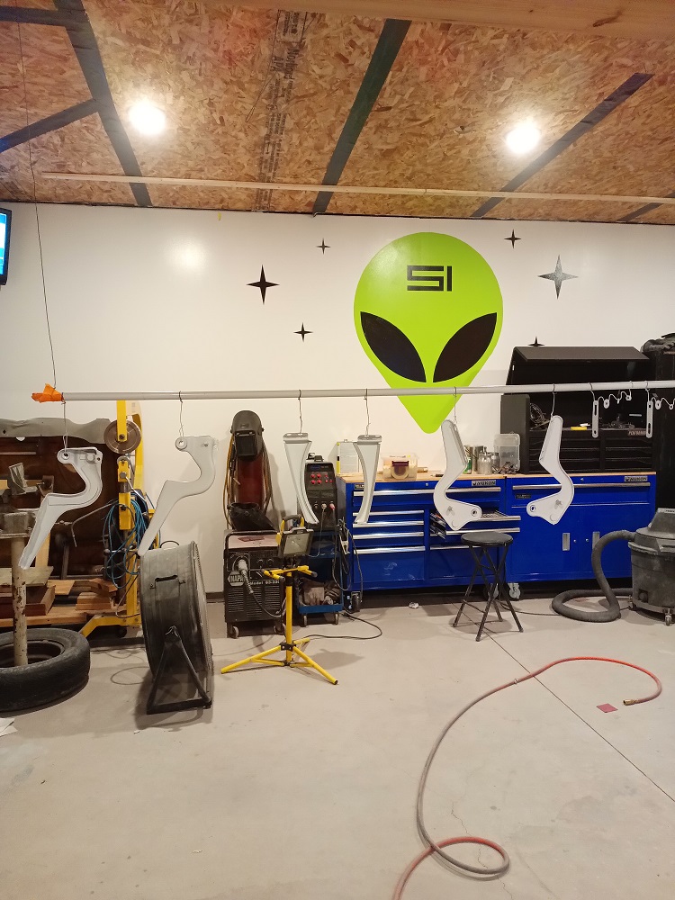

This factory 6 managed to escape the forces pulling it into a black hole never to be seen again. It was not without every ounce of thrust it could muster and it was not without suffering a considerable amount of damage. The crew patched it back together the best they could with primitive tools and scrap they found floating in space. fortunately they crash landed in easy reach of the secret facility known as Area51Werks. The owner is someone you may or may not know. Juergen Lives in Washington. The car will eventually end up on the other side of the pond. But for now it is on it's way to the final stages of completion. It was not like this in the beginning....

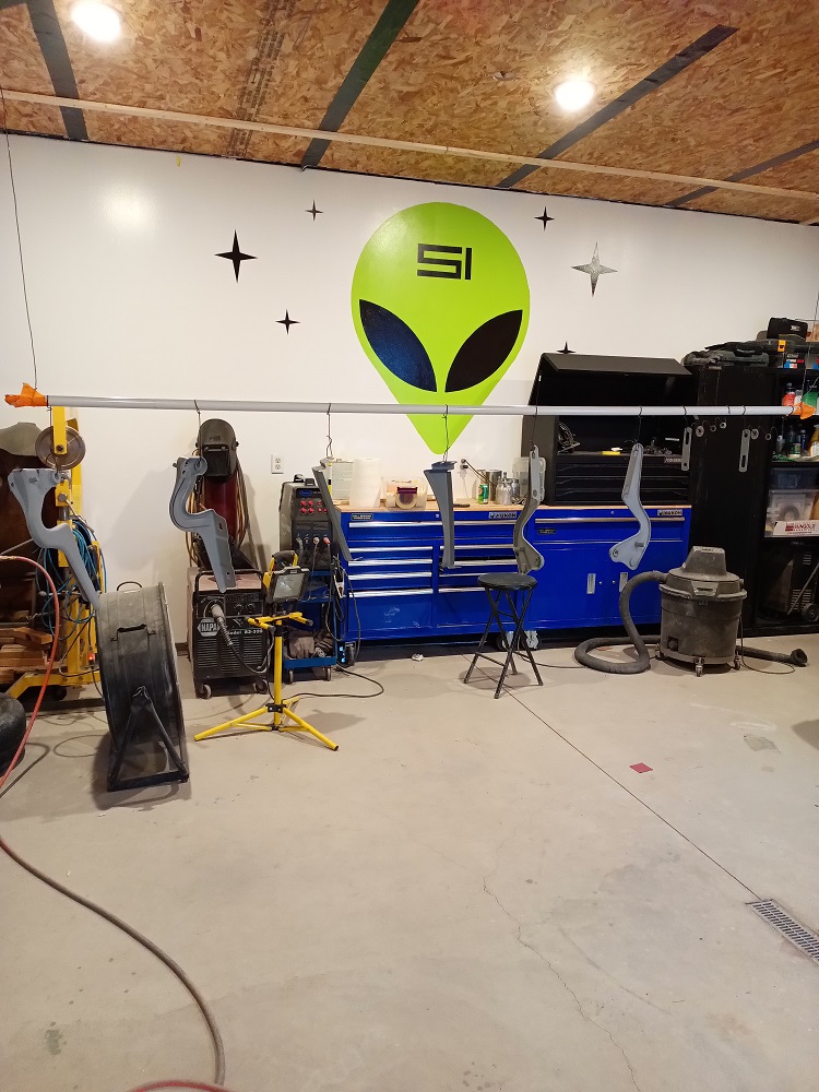

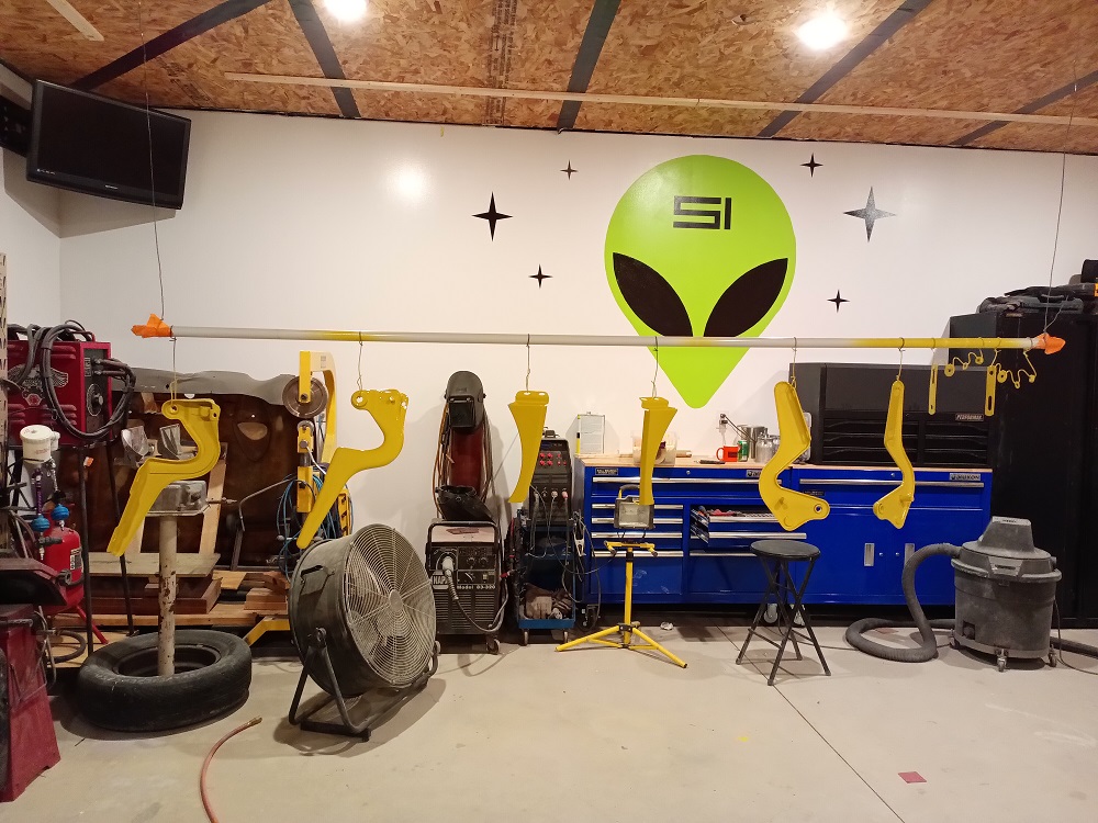

Epoxy
White Sealer as a base under the color
Color
And so it begins..... (IMG:style_emoticons/default/assimilate.gif)

Front yard mechanic   I really like your shrinking tool is that vintage ...   May 10 2023, 05:42 PM
rick 918-S   I really like your shrinking tool is that vintage...   May 10 2023, 08:51 PM
