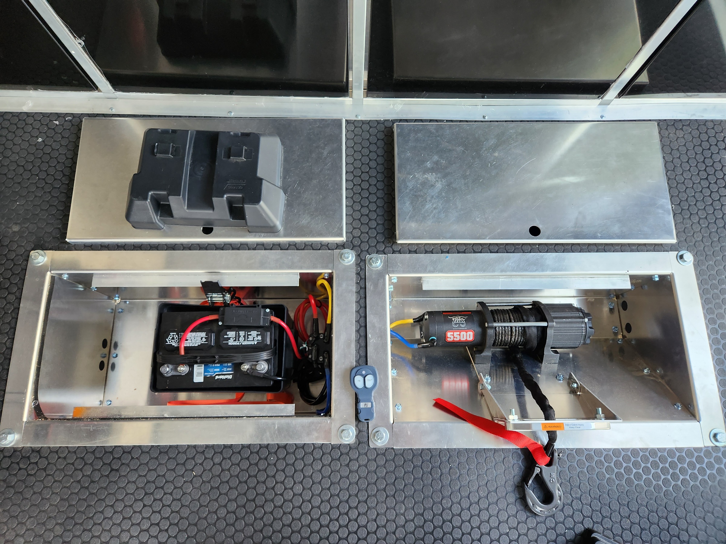

4. Also ordered a winch kit from the same http://www.midwestracecabinets.com site. It installs in the floor and looks pretty slick. Got the matching box for the battery and will install a solar panel on the roof to keep it charged.

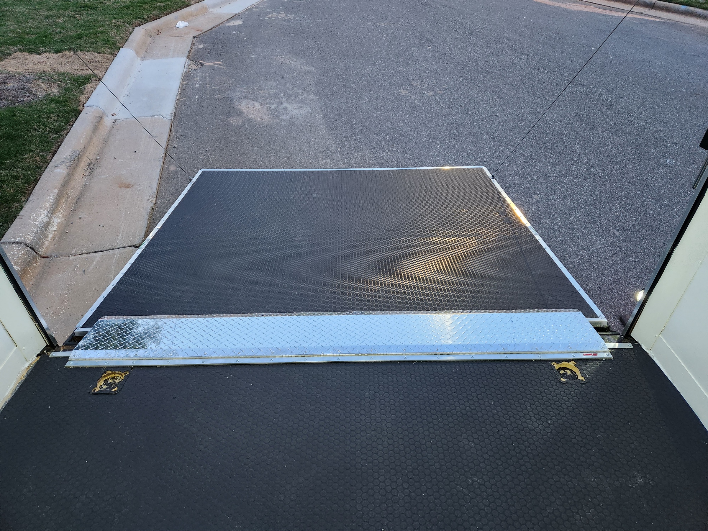

Made some good progress. Decided to glue the floor down as i really cannot stand wrinkles. Trimmed out the back door with L track. Installed the gap cover. Installed battery and hooked up the winch which now works!
Almost there with only a few things left to do. Have to put trim back down after gluing the floor tonight. Need to put etrack on floor and walls. Mount the solar panel and hook up to battery. And then hard wire the electic jack. Oh and install old and new accessories like fuel jug holders and fuel funnel (had already), and new stuff like spray can rack, broom holder, helmet and suit valet, and jack holder. All those take just a few minutes to install once i sort where they go.
