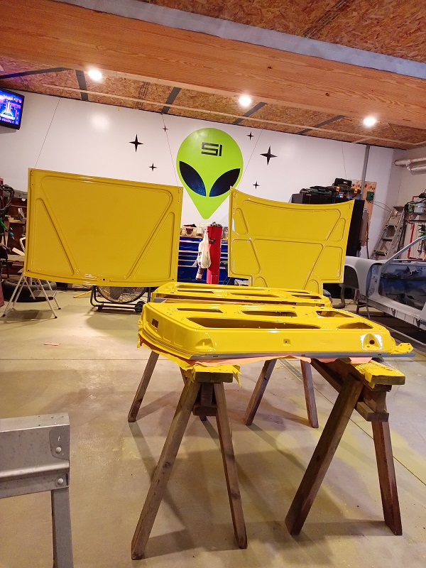

rick 918-S   RE: Another 6 Emerging from the Black Hole Slowly coming back to Earth   May 13 2023, 06:25 PM

Root_Werks   Color! Looking great Rick!   Jun 16 2023, 10:33 AM
