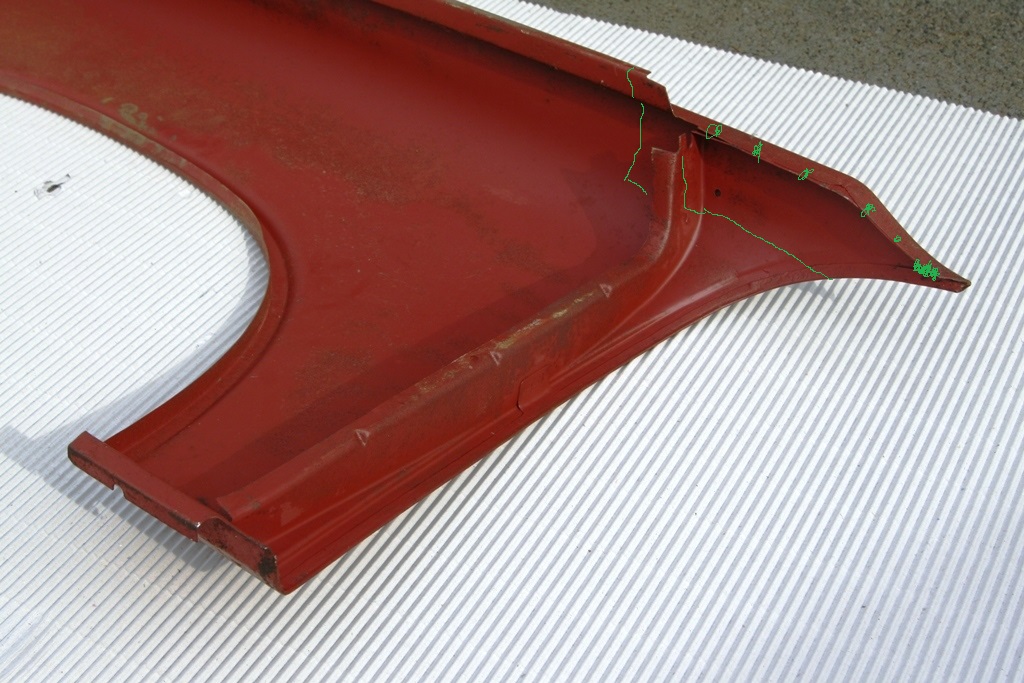

If it was removed it looks to me like the only way to get to the spot welds on the underside would be a belt sander, which probably also means welding in a new flange once the piece is out (maybe would be needed anyway).
Looking at this pic of a NOS quarter from Montreal914's thread, I've added green dots where the spot welds go through two layers and lines where it looks to me like cuts would be needed. @Montreal914 does this look correct? It looks to me like once the spot welds are removed through the double wall part of the quarter, then cuts could be made inlcuding a cut through the vertical piece that attaches to the top of the door pillar (don't think it would be possible to even see those spot welds (assuming there are some) let alone see them.

Montreal914   This is a pretty complex area. From one of your pi...   May 23 2023, 09:52 PM
