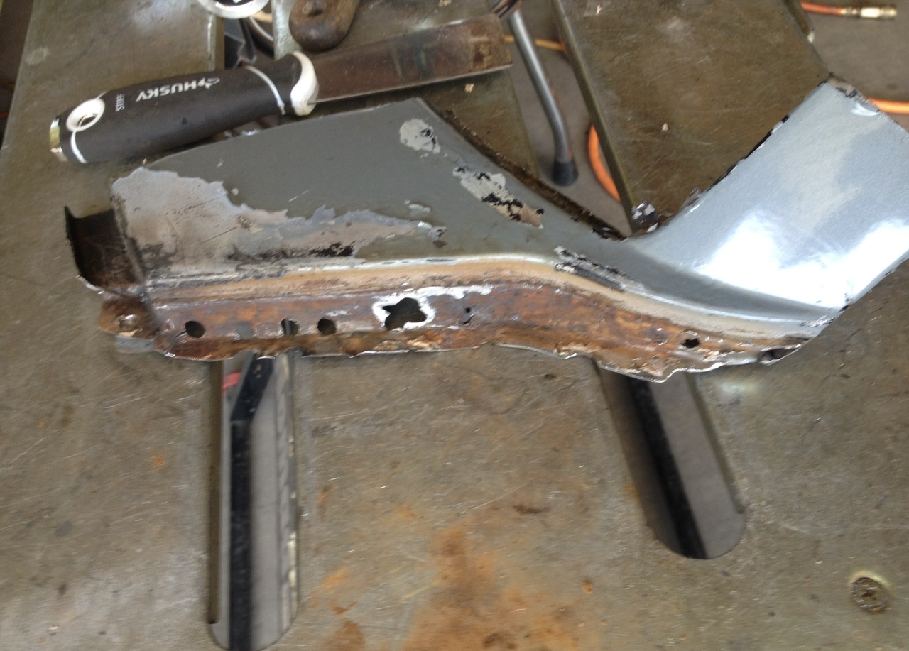

I looked for some of the photos I took, this is the cowl section I used, it was more difficult than most as I needed to save both sections, this is before the new sections were available.
You can see here that the rust is surface mostly and after some tig work I can even use the drill holes for plug welds.
