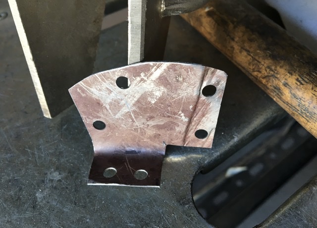

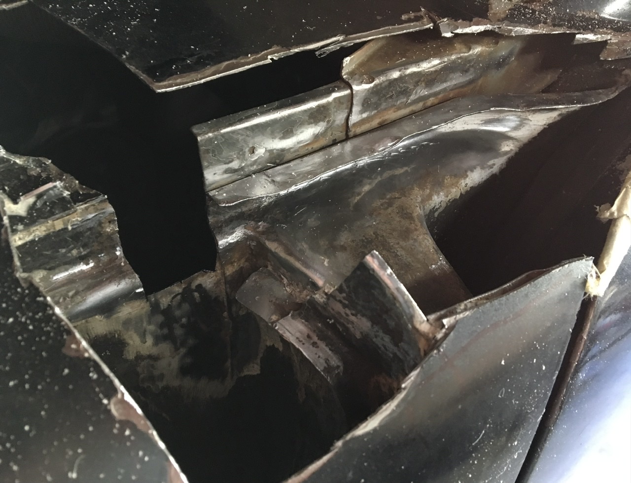

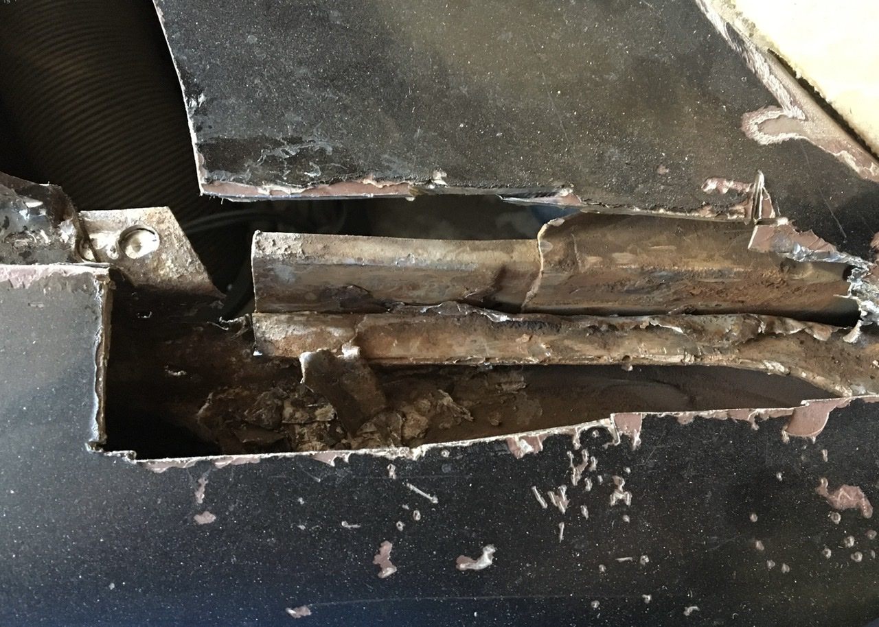

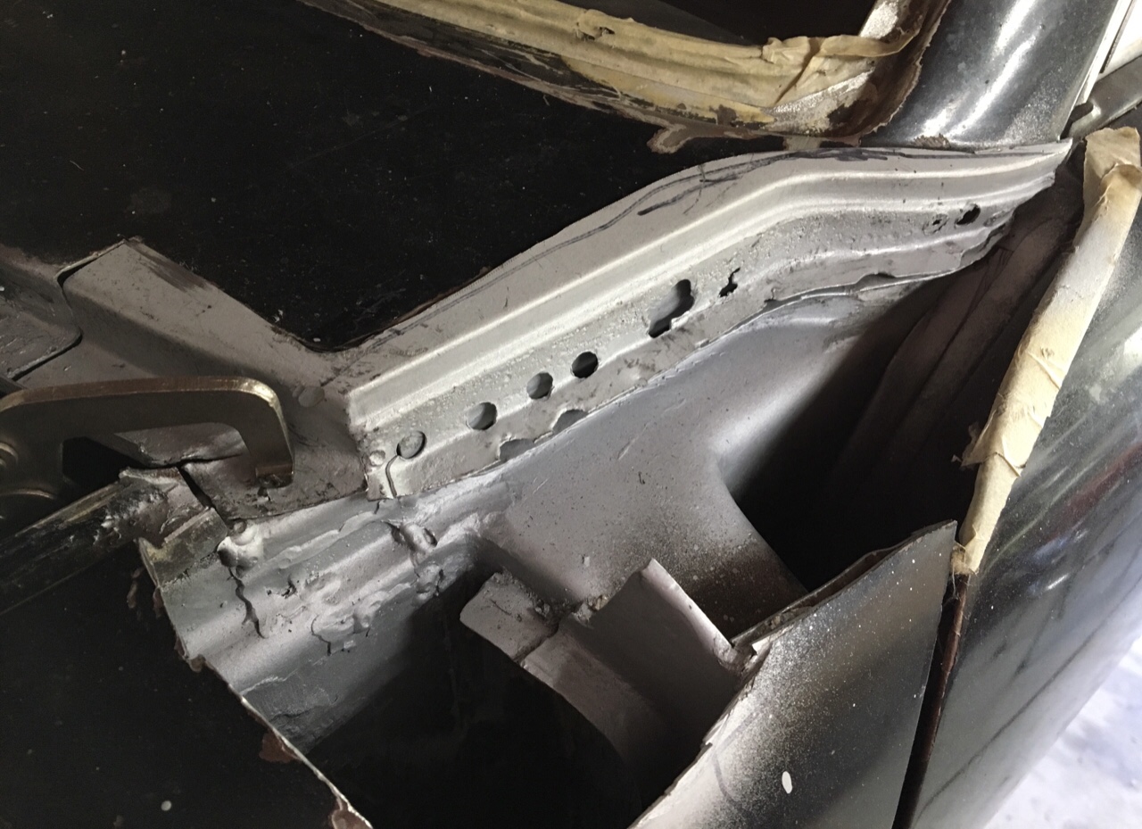

I found more photos of the repair.
I cut the fender back in small sections till I get the work space I need.
Once I have enough working space I remove all signs of rust.
This piece had to be fashioned to close the gap where rust has been removed.
If the process takes me a bit of time, I coat the parts in zinc based weld through primer, (it’s easily removed with paint thinner as it doesn’t have binders in the paint), also if I don’t remove it from creases and folds it is great rust protection.
It takes a fair amount of time but the results are well worth it.
