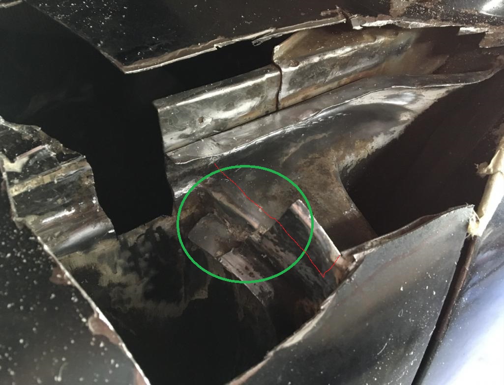

Nice work. In my case I'd be trying to save, repair, and reuse the quarter piece that I'd cut out. On your image below, I've drawn a green ellipse around the vertical part that sits on top of the door post. You appear to have removed a chunk including where it spot welds to the door post. The red line is where I'm thinking I could cut. Then upon re-installation of the quarter section I could butt weld along that seam where I'd made the cut. I find this area a bit abstract to look at so I'm trying to ensure that I understand how this location all goes together (e.g., took me a while to figure out that the back part of the top of the quarter is double layered).
