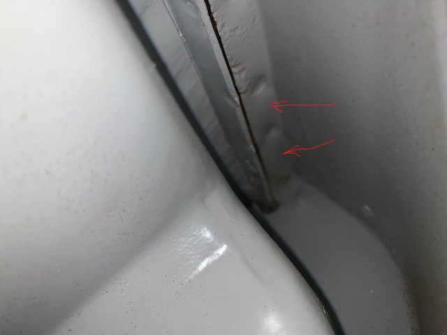

This is a pretty complex area. From one of your picture my concern is here:
![]() Where the arrows are pointing the metal is bulging. Why is that? Well that is because there is rust in between the 2 layers there and it is pushing the metal out yet the spot welds keep this together. So the question is how to go in there. (IMG:style_emoticons/default/idea.gif) The green circle you have in mgphoto's picture is near the "upside down "J" (for lack of better description) joint between the inner layer of the fender (refer to the OEM fender picture), and the area in front of the door. That would be a real pain to drill the spot welds there. So your suggestion of the horizontal cut above it and butt weld seems like a possible solution. Edit: I guess using the narrow belt sander you might be able to reach the spot welds but you will have to grind the two fender layers to get to the spot welds that are bonding to the cowl. I would do the other cuts first, then maybe you will be able to pull out the fender and rip at the cowl. It will be bad anyway and you will need to repair it. The fender might not be too bad. The weakest link will let go first. So is there a gain to want to use the belt sander? In the end it will damage pretty badly that area. (IMG:style_emoticons/default/sad.gif) |
