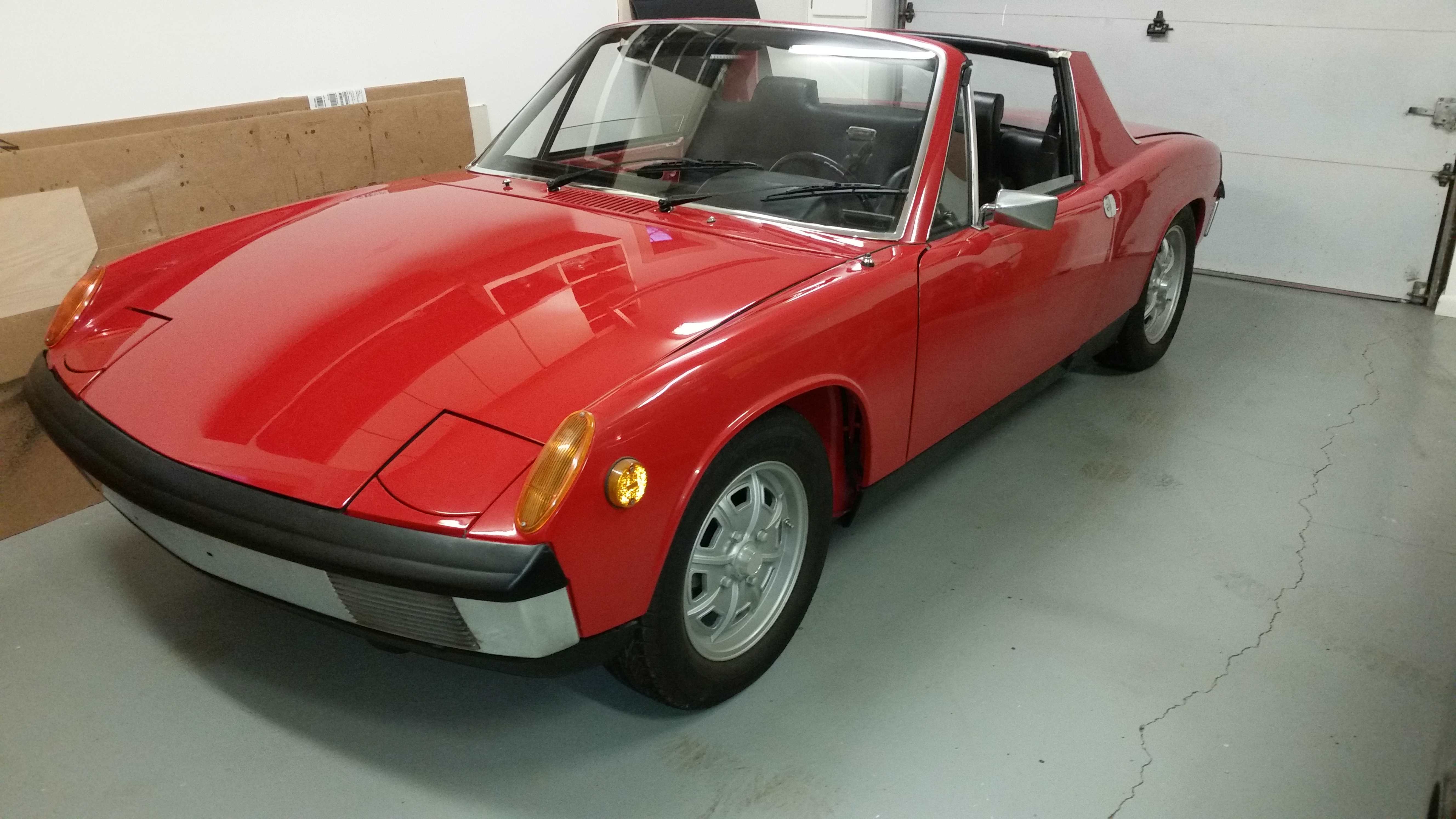

Thank you. I did switch the terminals at the pump, and it works great. I finished restoring the car about 3 years ago and could not get the fuel injection system to function properly, so I stored it and restored another one with carbs. That car is done, and I have been driving it, so I decided to get the fuel injected one running properly. After putting in the new fuel pump and blocking off the AAR valve the car is running good. It even idles at 800 rpm. It is a nice car and now I can drive it this summer.
Fuel Injected Car
Car with Carbs
