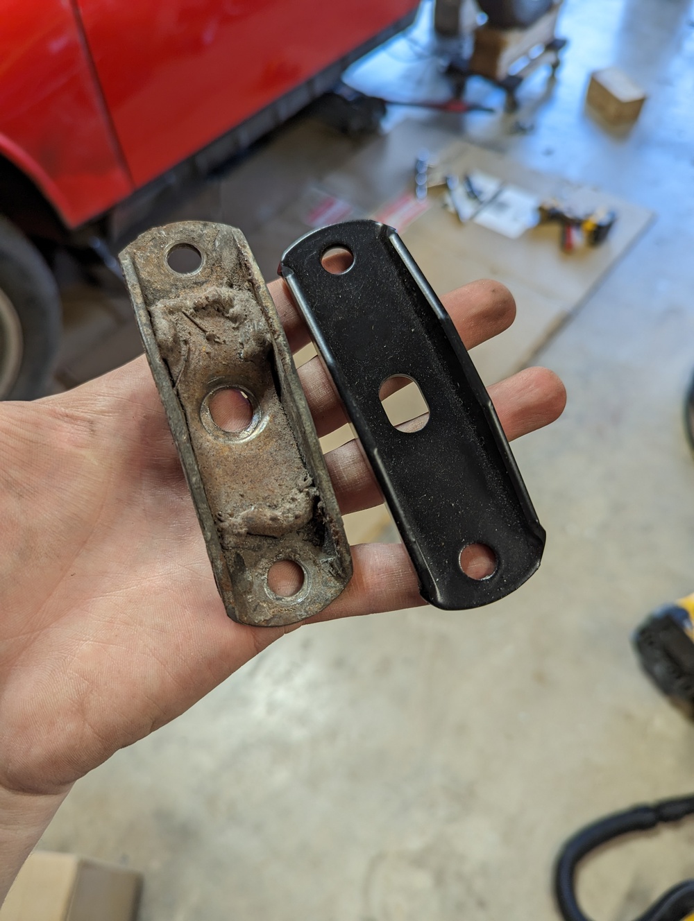

Quick update on this project. Long story short, I started residency in Texas andso have been too busy to make much progress on the car. It's been a bit frustrating, and I have done some small projects but it still has a lot of odds and ends before it will be drivable.
New engine bar brackets from bdstone914, old ones were trash:

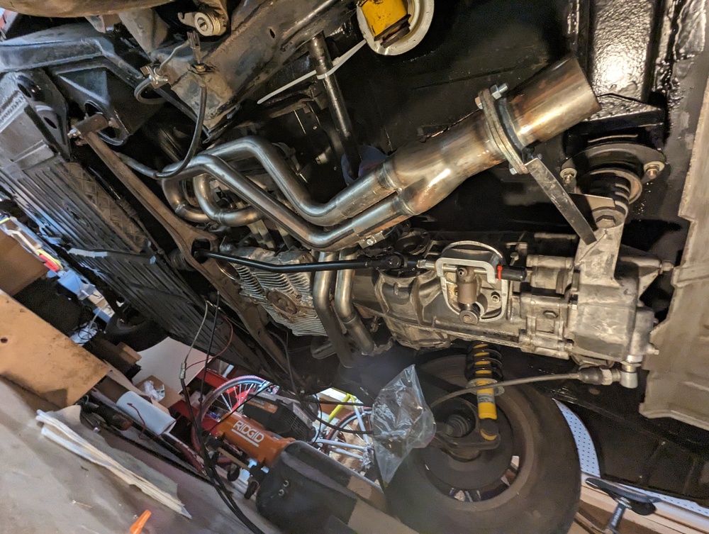

New MSDS header with spintech muffler (muffler needs to be welded on). Also a Tangerine shift linkage in there somewhere:
(IMG:http://www.914world.com/bbs2/uploads_offsite/i.imgur.com-23821-1685933360.1.jpg)

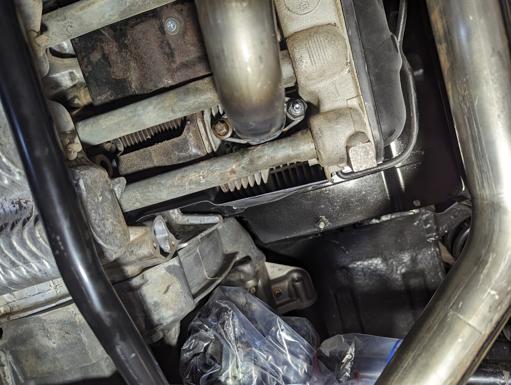

This engine has a couple delightfully random exhaust bolt heli-coils, including one that happened to be the same thread as an old E39 BMW head bolt...
(IMG:http://www.914world.com/bbs2/uploads_offsite/i.imgur.com-23821-1685933360.2.jpg)
