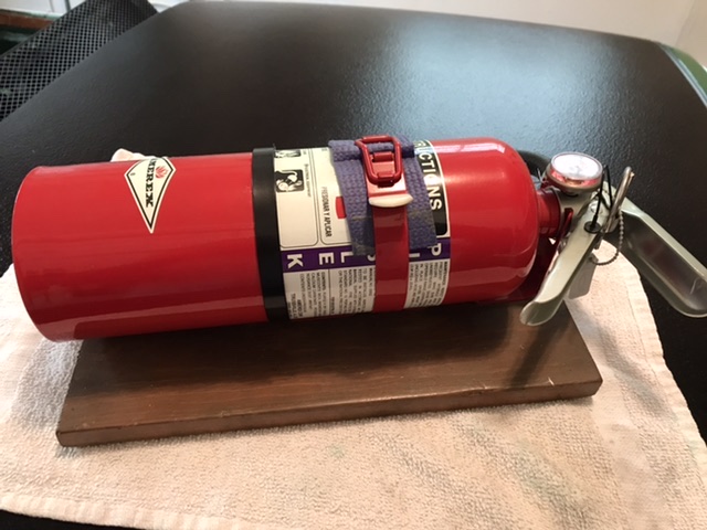

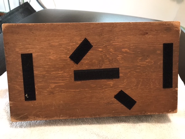

StarBear
post Jun 7 2023, 03:14 PM
Posts: 2,259
Joined: 2-September 09
From: NJ
Member No.: 10,753
@Stef914
Here’s my hobo setup. Pics below. 5lb Purple unit.
I think I’ll replace the board with one that has a rougher bottom and is longer to extend past handle and bottom.
