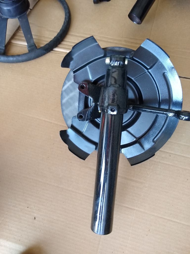

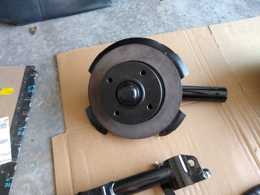

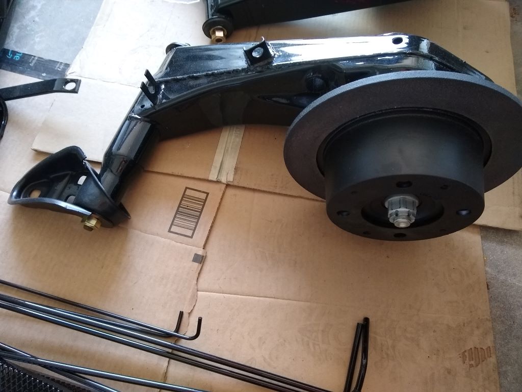

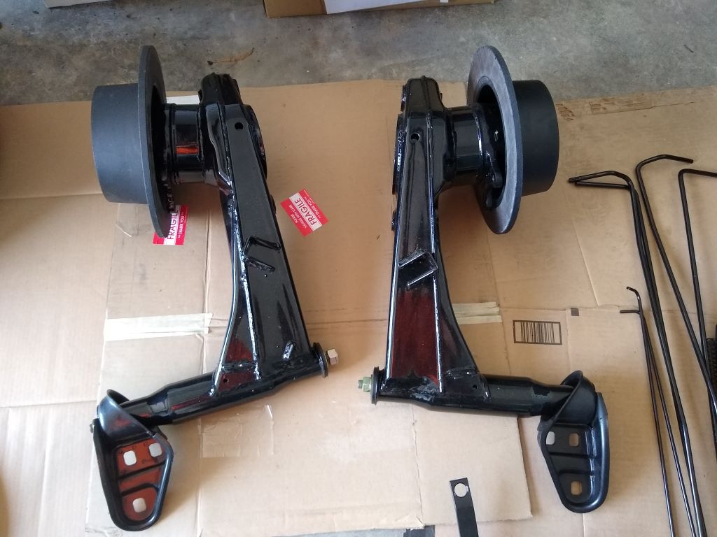

I can't believe how long it has been since I last updated this thread.
I have completely refurbished the suspension. I am now waiting on the body shop to complete the repairs to the chassis. Hopefully, I'll get it back before the end of summer.
Here are some photos of the refurbished parts.
I also refurbished the steering rack, purchased new tie rods, ball joints, torsion bars,
and springs.
