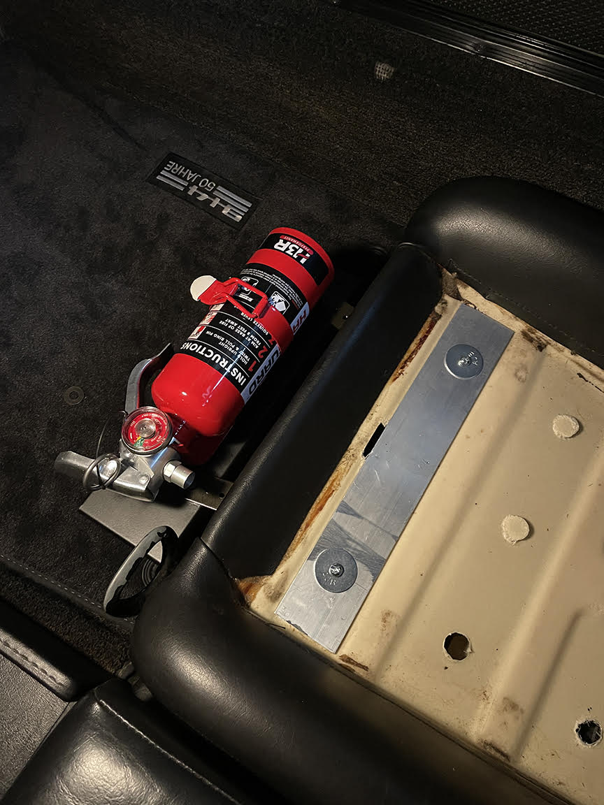

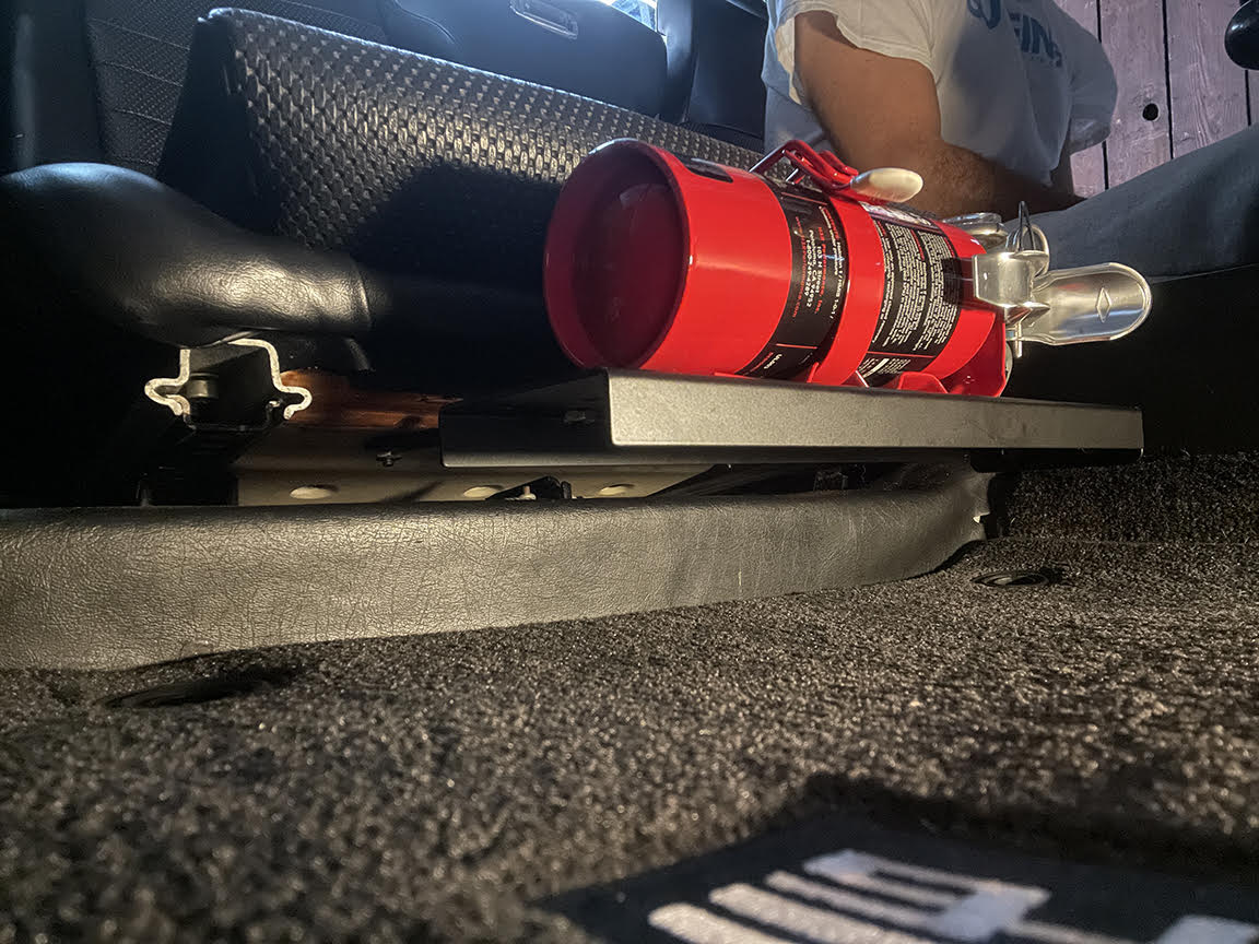

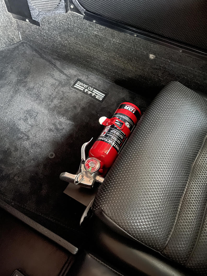

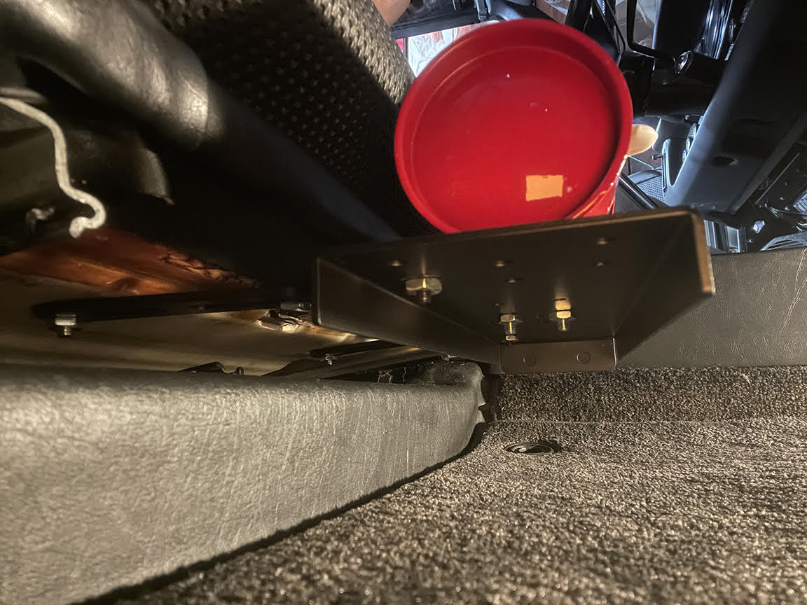

Thank you everyone for sharing their fire extinguisher solutions ..
I was able to mount it under the passenger seat using the universal mount from H3R,
thru an homemade aluminum plate that attaches to the fibergalss seat without having to drill any holes... Attached Image Attached ImageAttached ImageAttached Image
