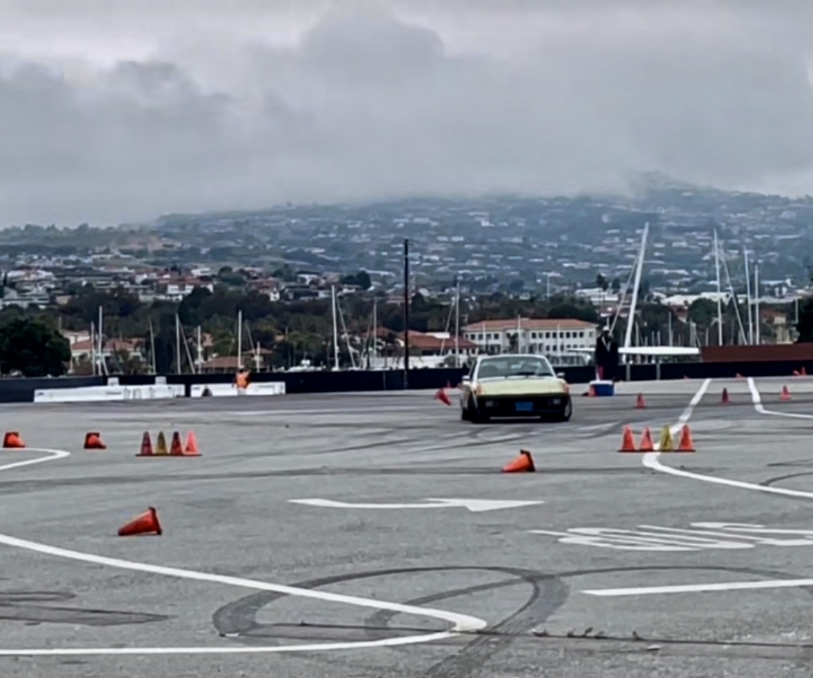

The ability to hold the car at angle really helps when you want to rearrange the course when someone through the corner should be tighter than you do! Attached Image
