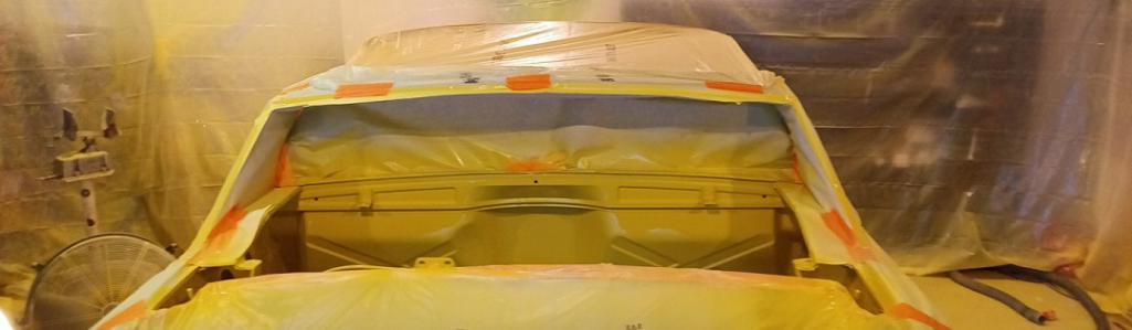

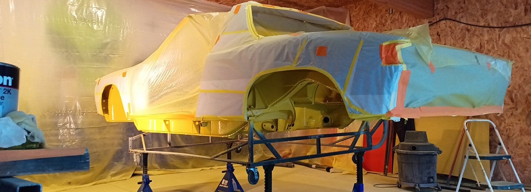

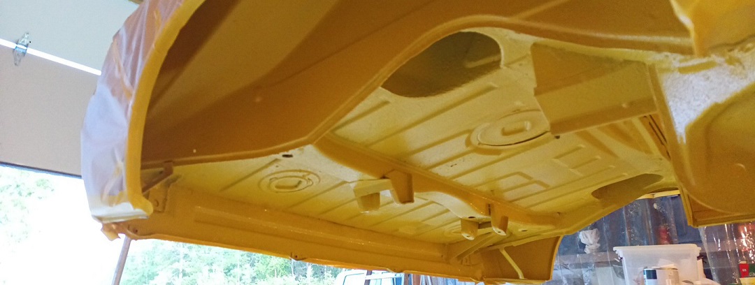

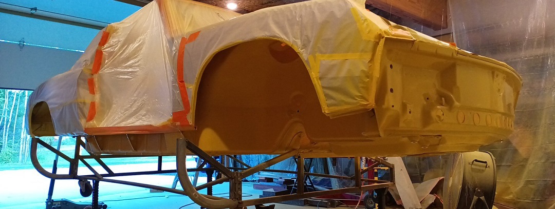

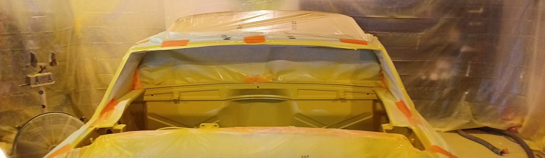

rick 918-S   Need to paint the gas tank well, the interior and ...   Jun 16 2023, 12:22 PM

rick 918-S   RE: Another 6 Emerging from the Black Hole Slowly coming back to Earth   Jun 17 2023, 04:44 PM
sixnotfour   Rick"s a Winner... :chkflag:   Jun 17 2023, 09:47 PM
rick 918-S   RE: Another 6 Emerging from the Black Hole Slowly coming back to Earth   Jun 18 2023, 02:53 PM
East coaster   Nice! Isn’t masking fun (not)! I’m p...   Jun 18 2023, 07:12 PM
rick 918-S   Nice! Isn’t masking fun (not)! I’m ...   Jun 18 2023, 08:43 PM
