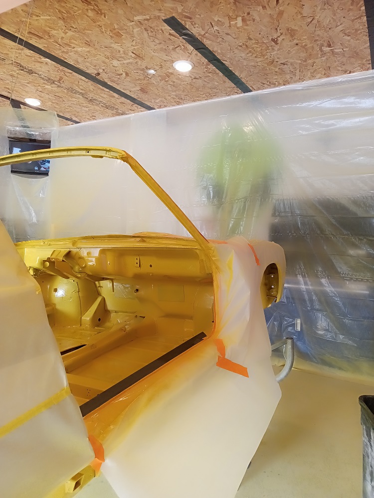

rick 918-S   RE: Another 6 Emerging from the Black Hole Slowly coming back to Earth   May 13 2023, 06:25 PM
rick 918-S   RE: Another 6 Emerging from the Black Hole Slowly coming back to Earth   Jun 16 2023, 06:43 AM
BillJ   Super satisfying part of the resto   Jun 16 2023, 08:19 AM
rhodyguy   About ready to head west?   Jun 16 2023, 08:21 AM
Daiberl   About ready to head west? Car will head east no...   Jun 16 2023, 10:06 AM
Root_Werks   Color! Looking great Rick!   Jun 16 2023, 10:33 AM

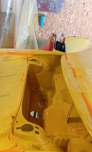

rick 918-S   Need to paint the gas tank well, the interior and ...   Jun 16 2023, 12:22 PM
flyer86d   Very nice Rick and I like the color. Oh wait, that...   Jun 16 2023, 02:32 PM
Bullethead   :trophy: Truly impressive work! Just found th...   Jun 16 2023, 04:27 PM
Cairo94507   Truly amazing work Rick. :beer2:   Jun 17 2023, 06:10 AM

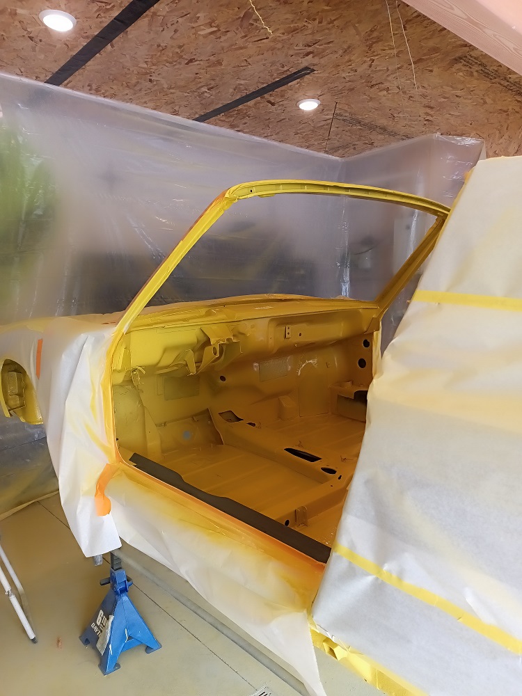

rick 918-S   RE: Another 6 Emerging from the Black Hole Slowly coming back to Earth   Jun 17 2023, 04:44 PM
sixnotfour   Rick"s a Winner... :chkflag:   Jun 17 2023, 09:47 PM

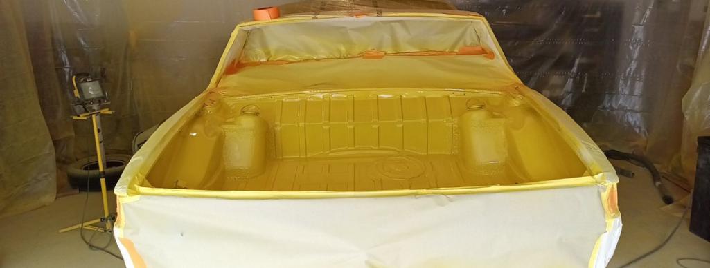

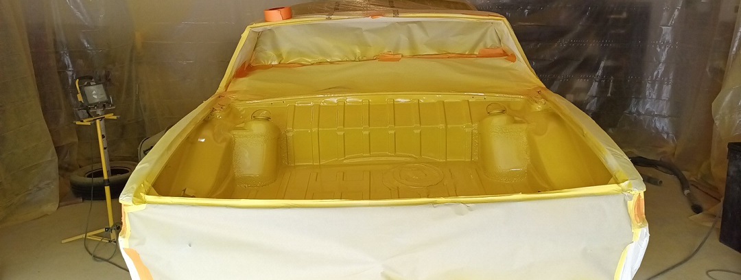

rick 918-S   RE: Another 6 Emerging from the Black Hole Slowly coming back to Earth   Jun 18 2023, 02:53 PM
East coaster   Nice! Isn’t masking fun (not)! I’m p...   Jun 18 2023, 07:12 PM
rick 918-S   Nice! Isn’t masking fun (not)! I’m ...   Jun 18 2023, 08:43 PM
