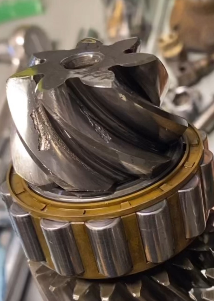

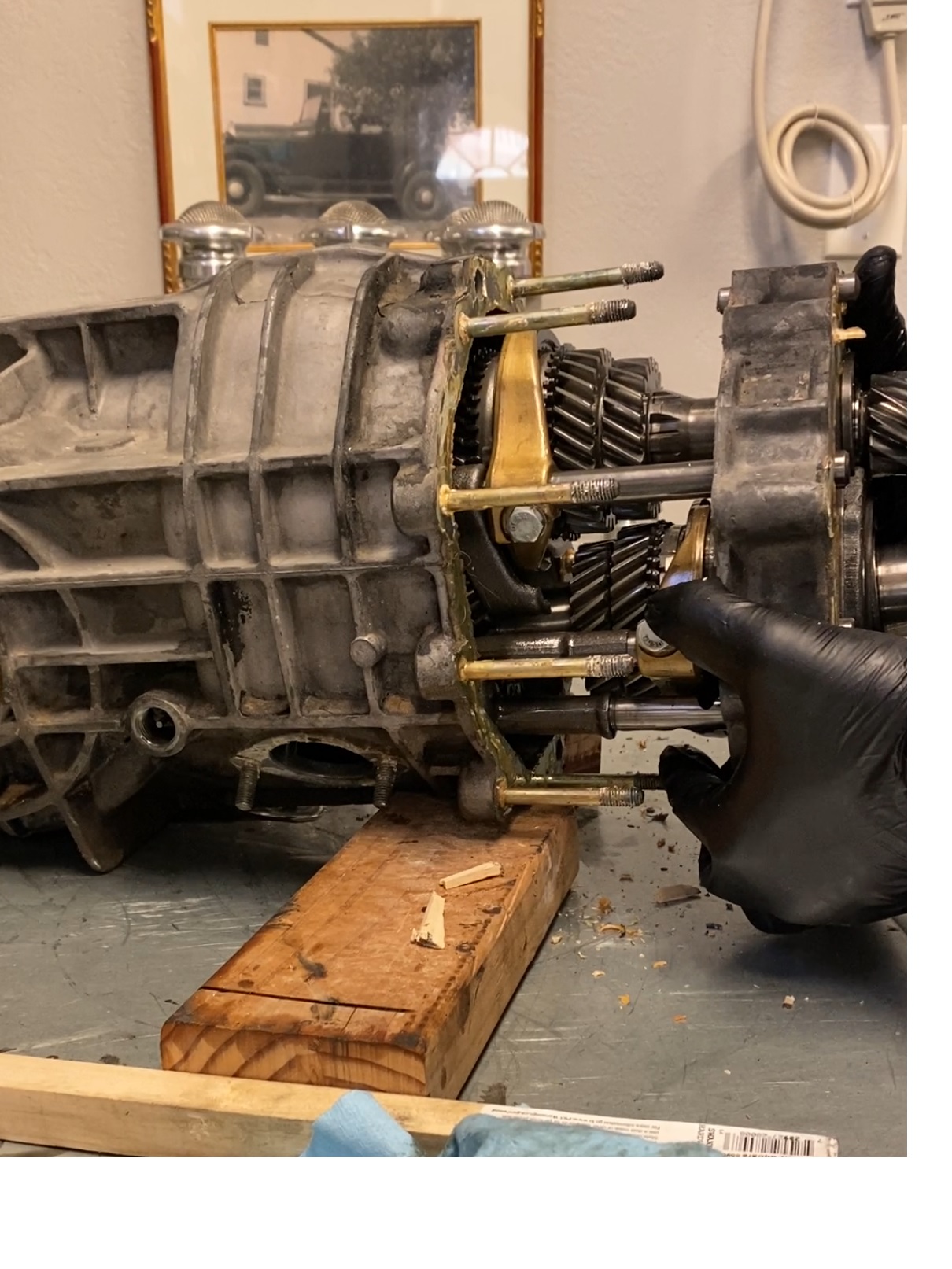

I'm pretty sure this is the cars original transaxle, and after opening it up, it definitely looked like a 156k miles had been run through it.
Notably, the pinion gear is trash. Check out the valleys of pitting!
So I'm in the market for a new R&P for this 75 if anyone has a good set.
The gear (don't know what it's called) that drives the reverse gear is also chipped. Not sure if it's savable.

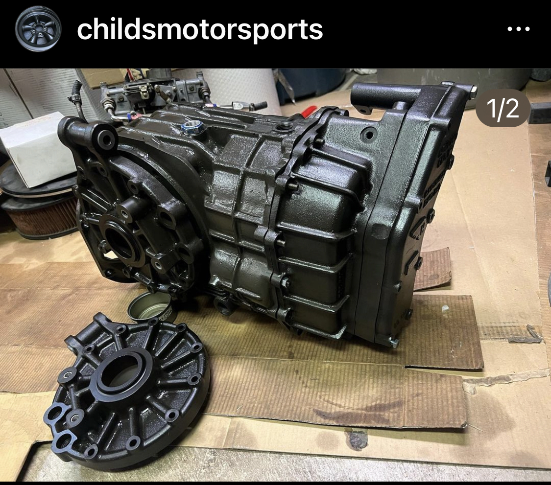

I thought it would be cool to give the case the black mag treatment from Childsmotorsport. I called and talked to Chris Childs over there and got a price to do the case. He bead blasts and then applies the same old school factory (Chromate?) coating like some of the early race boxes had.
Here's some of his work:

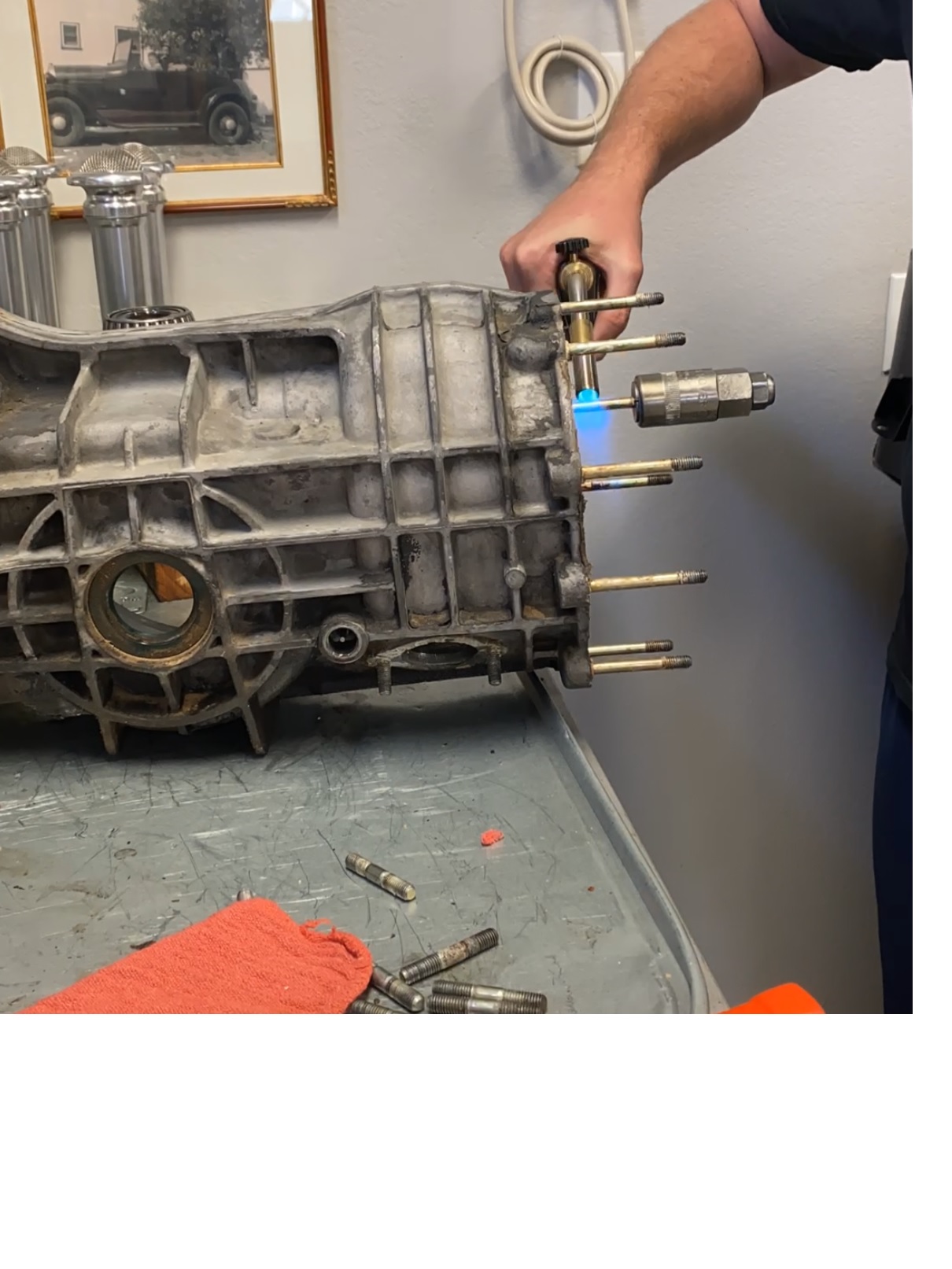

Removing the studs was pretty easy and fun. I love my snap-on stud remover. It's one of those tools that I got from my late dad and so I associate it with him and using it gives me nostalgia and joy.
A little MAP torch to loosen things up and out they come.
Next up is removing the races, which I've never done. Any tips? Then I can clean the case and send off to Chris for his coating.

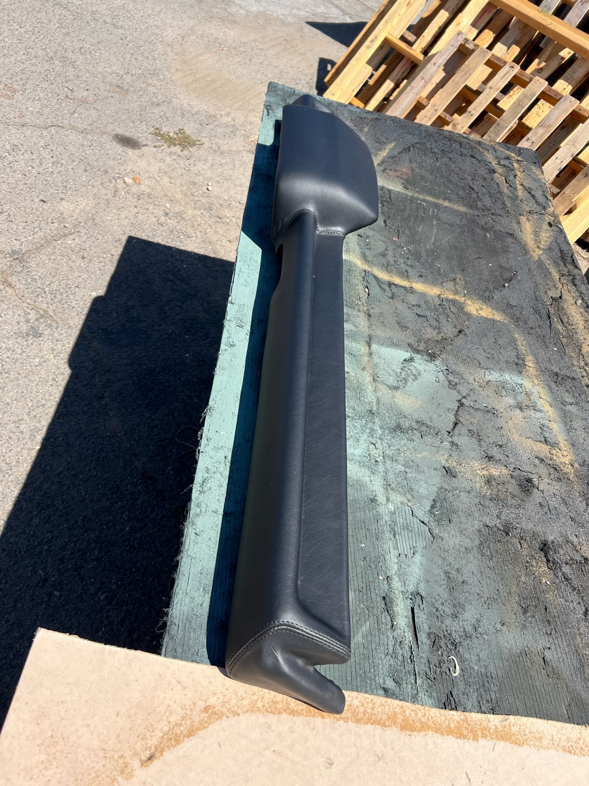

In other news, my interior guy Dorian from autos international reached out. There were definitely some hurdles namely the rear piece behind the seats was in pretty bad shape. He doesn't have a correct panel on hand so his trimmer was worried it wouldn't fit right because the backing was water damaged and warped.
Luckily Scott over at 914 rubber came to the rescue and supplied me with an old backer pad. I can fit that in my car, then send to Dorian to get the German vinyl applied.
Speaking of interior the dash is done. Though it was more expensive, I wasn't happy with the aftermarket rubber dash, so I decided to rescue the original. The original always fits perfectly and it's way way lighter.
Here it is in the sun, getting that vinyl to tighten up. Or is it leather? Can't remember what I opted for for the Dash. I think I went all German Vinyl. Dorian uses the real stuff. That shop is amazing.
