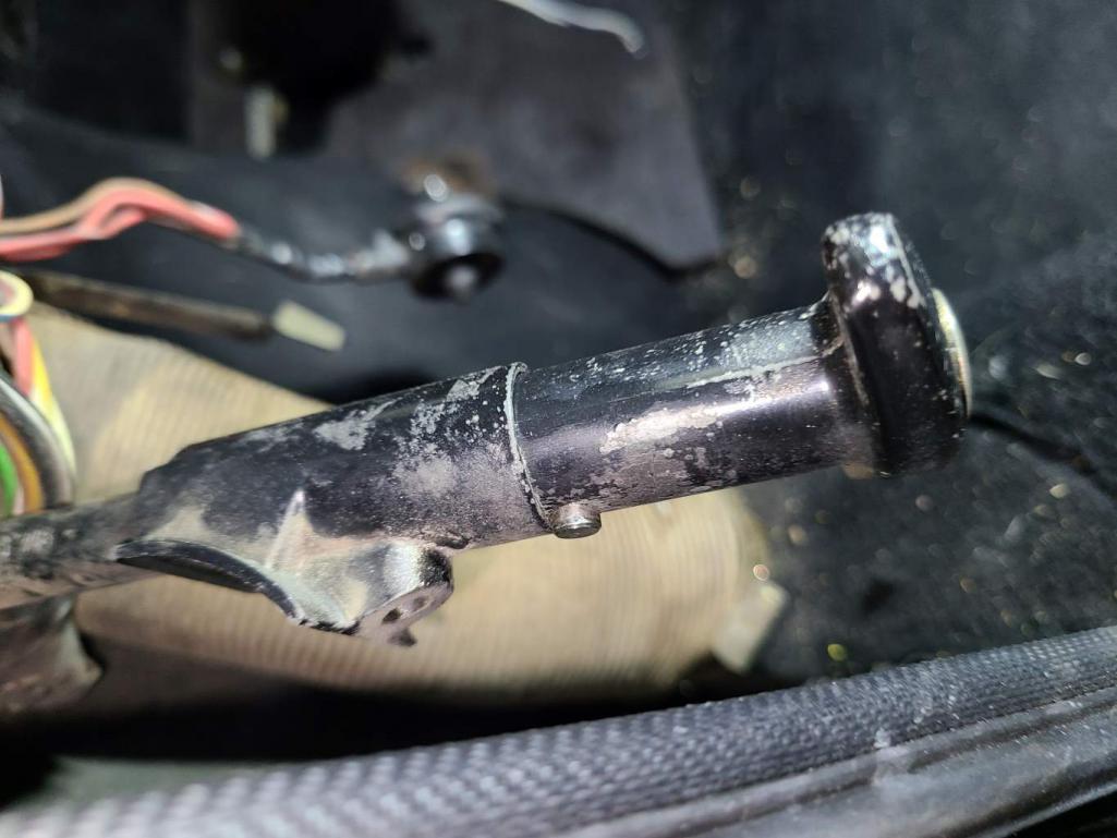

My car was disassembled for painting many years ago and put together hastily. Most things I dig into need hardware, or adjusting or replacement. The front trunk handle is the latest.
It never looked like a stock handle should. There is a chrome cylinder, 5mm to 6mm in diameter sticking up a bit from the handle. That stops the handle from going into the handle mount so the whole handle sticks out a bit and wobbles. When I took it apart, I noticed the small stop screw on the handle slider is not installed.
It does function correctly, just with a wobbly handle in the holder, the holder mount is tight to the car body.
Questions
Do I just press that small chrome cylinder down until it is even on both sides? What does it do?
What are the specs for that stop screw? Cant see any details in the PET.
Will I have adjust the cable or sleeve when I get it put back together correctly.

Wow! I did not know I was playing stump the World today. 100 views and no suggestions yet. How about a pic? Maybe that will help.

L-Jet914   @NARP74 Went out into the garage. Here is what mi...   Jul 17 2023, 06:50 PM
L-Jet914   second photo of orientation of the release handle ...   Jul 17 2023, 06:51 PM

NARP74   @L-Jet914 thanks for the pics, that is what I am ...   Jul 17 2023, 08:18 PM

NARP74   Looking for info on this screw. Where the screwdr...   Jul 18 2023, 11:41 AM

NARP74   I have been told by @TheCabinetmaker that the sp...   Jul 18 2023, 12:40 PM
NARP74   Well, I have a good update and an epic fail update...   Jul 29 2023, 01:24 PM

TheCabinetmaker   The cable must be screwed in till it stops. The ad...   Jul 29 2023, 02:16 PM
NARP74   Sounds like I have some work ahead of me. I think...   Jul 29 2023, 07:50 PM
NARP74   I think I figured out what might have happened. B...   Jul 30 2023, 09:32 AM
NARP74   I'm in! Necessity is the mother of all sh...   Jul 30 2023, 10:08 AM
TheCabinetmaker   Broken sheath repair. 914 rubber has them, I think...   Jul 30 2023, 10:23 AM
NARP74   That is where I got the idea that the sheath was j...   Jul 30 2023, 10:33 AM
