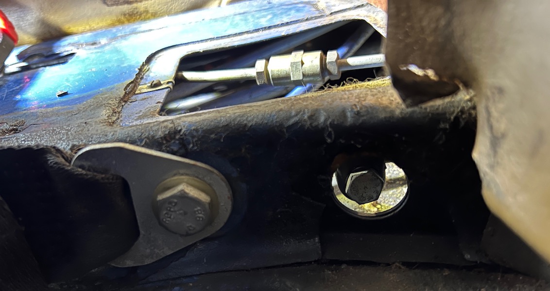

This is a “How to” on replacing the worn shift linkage bushing for the 69-72 tail shift 914’s. This post was super helpful. Thanks for taking time to write it up. move the driver's seat all the way forward then pull vinyl down and you'll see access hole for socket instead of using 2 wrenches like ur pic shows. The hole is right below where access cover is. Makes things easier doing this. Here is a photo of the aforementioned access hole. Can we just call it a-hole? (IMG:style_emoticons/default/biggrin.gif) |
