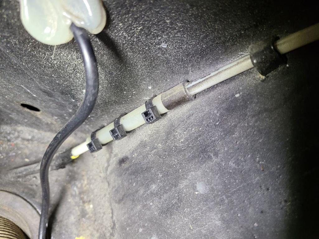

I'm in! Necessity is the mother of all shortcuts! I figured the cable housing was slipping in the metal tube on the firewall. When I got underneath to look at the handle assembly and saw the stop screw pointing down, I decided to take it out. That allowed me to pull more cable and sheath until the frunk latch opened, et voila! Frunk opened without major disassembly, which I should still look at some time later to be ready for this again.
