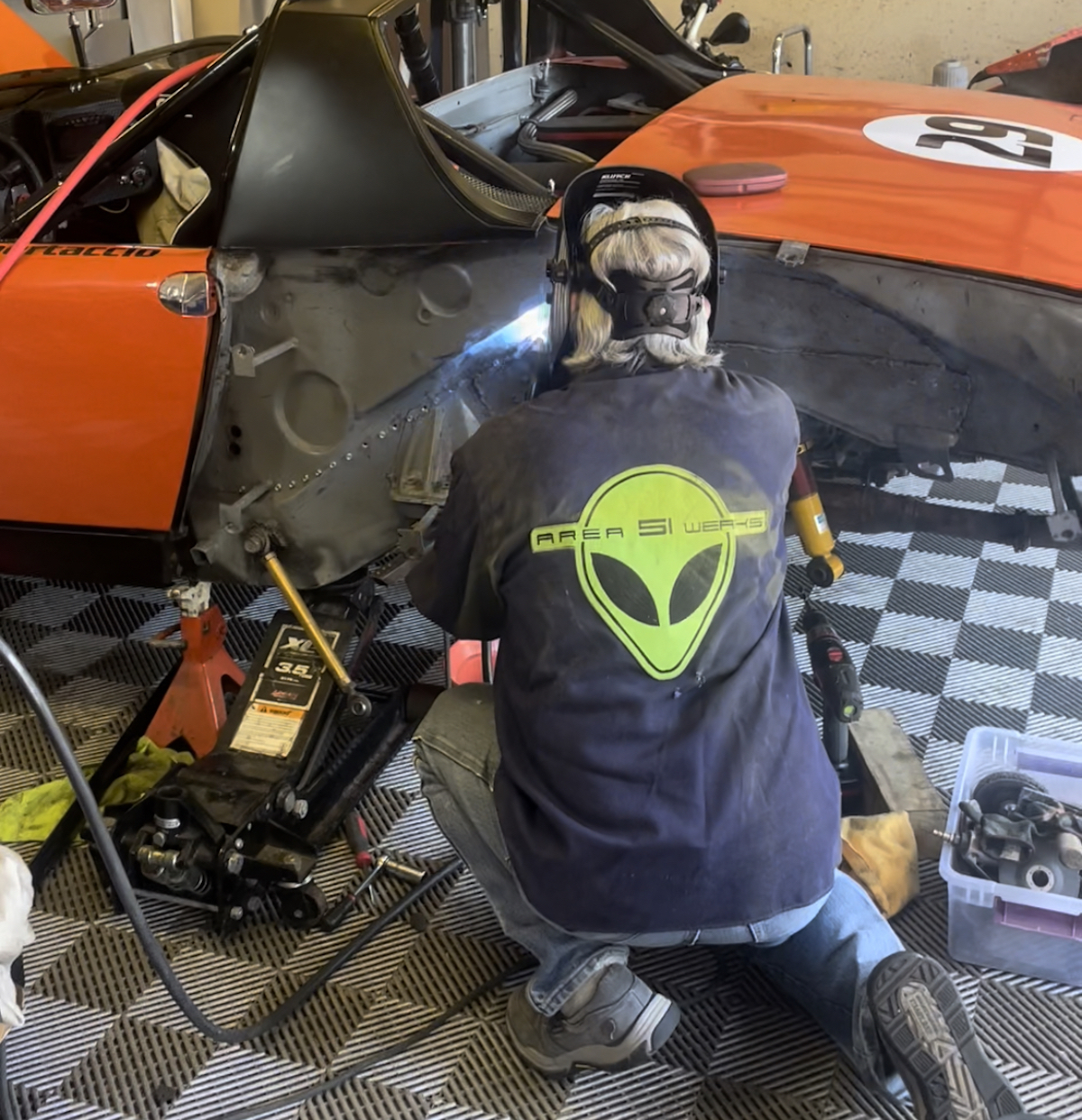

At some point during my procrastination window I fell into "get the 914 vintage race car ready for Road America mode" and quickly learned that I had some pretty serious chassis issues on the other 914 in my stable. Fortunately Rick (Rick918-S) came to the rescue there. You read all about that adventure here via this link:
http://www.914world.com/bbs2/index.php?sho...=366018&hl=
And here's a teaser photo of the work...
...and an on-track shot confirming Rick's repairs did the trick. See that vinyl face on the site of the car? No, that's not me, I'm not that vain, rather it's a tribute to my Dad. He raced this car long before I took it over. For better or worse as I've progressed into my 40s I look more and more like him.

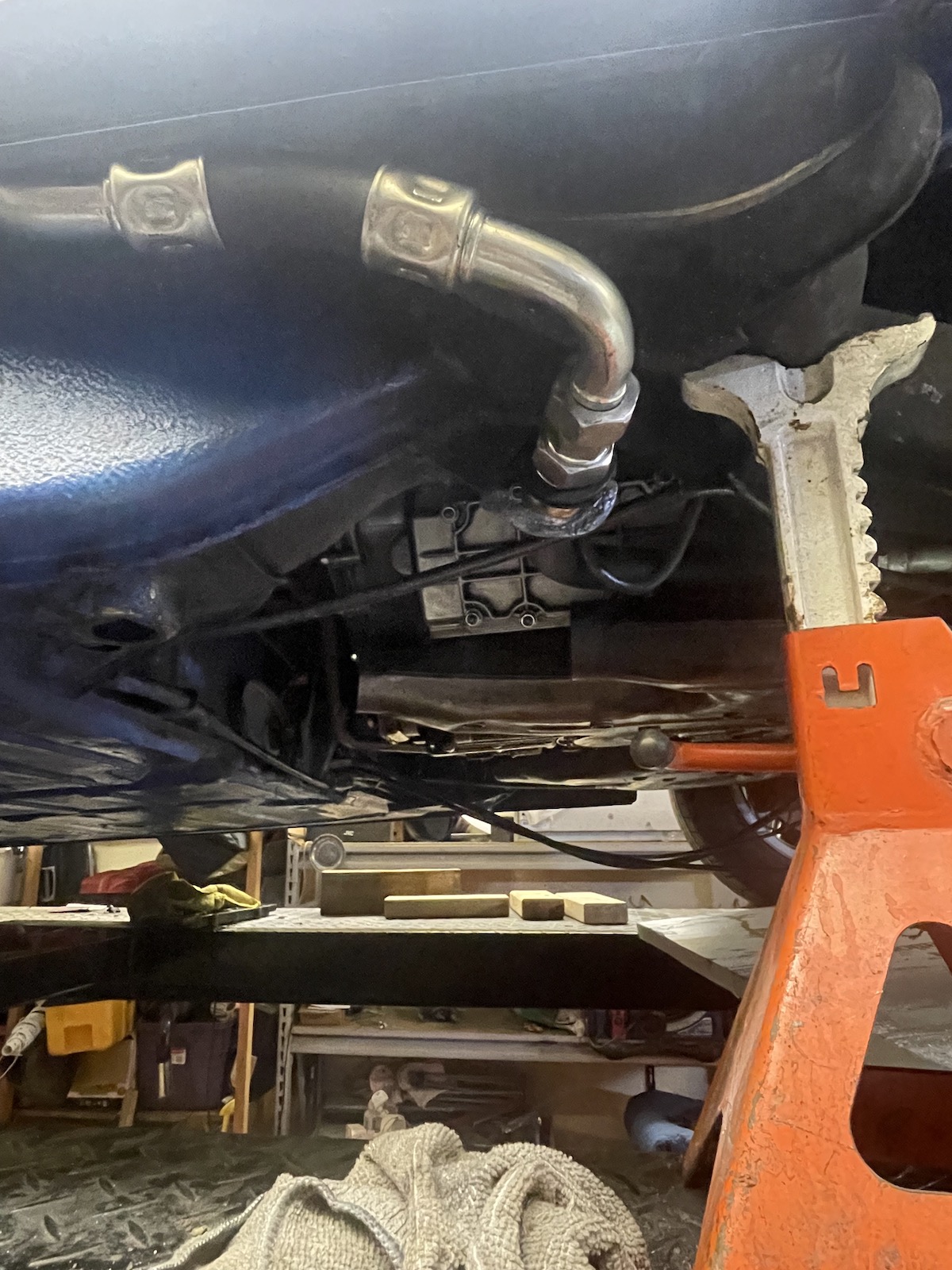

To do the job right I had to remove the oil tank. I'd done it before prior to shipping the car up to Rick in Duluth for the longitudinal/pan repairs, but it had been years. I remembered there was a trick to doing it, but that's all I remembered. So, after removing the LR wheel, rocker cover and other miscellany, I spent an hours or so wrestling the oil tank trying to get it out. It wasn't happening.
In my frustration I didn't snap any photos, but in a nutshell, when I installed the tank last time I had the lower line attached in such a way that it could sneak the tank in, however the fitting would not clear the chassis coming back out. After some thinking I broke out the dremel and cut the the darn hose fitting off. I somehow managed to do so without damaging the tank or the adjacent chassis area. I'd call that a win. Then, with the finesse of a freshman at his first homecoming dance, I spun the tank around and out of the darkest confines of the inner fender.
I reveled in my win, got distract with other life things, maybe s squirrel in the yard, or perhaps a combination for the next week or two until I resumed work on oil tank. I made quick work of installing the new lines and wrangling the tank back into it's home.
Here's a few upshots to prove I'd done my job.
