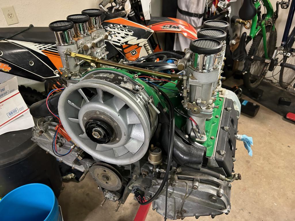

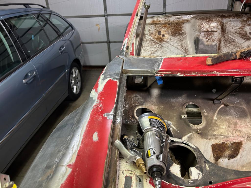

Made a patch panel inside the passenger side frunk weatherstip channel and some engine bits arrived! New wiring harness, 123 ignition distributor, studs to mount the PMO carburetors, and oil line restrictors from a 930. (IDK... Wayne D recommended them in his book...)
I know I know, the fan and shroud strap look ugly. This is where I have to say to myself "perfection is the enemy of progress." I've got bigger fish to fry with this project. I've acquired a 7R 2.4 block that I plan to build as the hotrod engine that will be all shiny. This 2.7 will hopefully just get me on the road.... someday...
