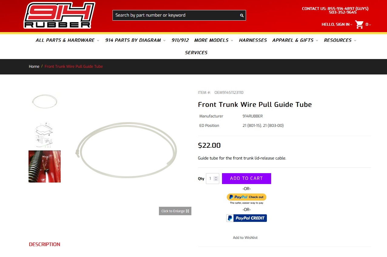

QUOTE(NARP74 @ Aug 12 2023, 07:12 PM) *
https://www.youtube.com/watch?v=MvbQ4wJak_c
Channeling Kevin Kline here...
So while 914 rubber was out of stock I spent a lot of time coming up with a nifty solution to the outer cable housing problem. I almost had it but my vertical lathe, AKA drill press could not handle the work and the part I started with was running out of metal. Then the part was back in stock so I just ordered one and it got here quick.
I started fitting it and it was very tight. The tube is roughly 6mm plus a bit. The old cable housing I had that was bad was 6.05mm, it slipped in pretty well, tight but it went in. The new cable housing was 6.35mm and was too tight to get in the tube, even with lube and some firm hands.
I started looking at the tube and decided it had some slag in it or something that was making entry difficult. I carefully drilled out the first part of the tube from the trunk area, cleaned it out and lubed it again.
I got the new cable installed up to the stop on the housing. I fed the wire in from the front seat and did a test fit, everything seemed good. I started to take it all apart to route the cable and lube it and the stop on the cable housing broke free and now I am back to the very beginning again!
@Mikey914 I know you are very busy and shorthanded, do you have any suggestions how I can repair the front trunk cable guide tubing I just bought?
Thanks, I'm showing these in stock and the version with the cable as a kit is too
https://914rubber.com/guide-tube-for-front-...release-cable-1
The stop is welded to the body of the tube. If you got a defective one from us we will be happy yo replace it. Our failure rate on these is pretty low, and with the process we use (if done properly) it should be non-existent.
You can PM me the specifics and I'd be happy to take care of this.
