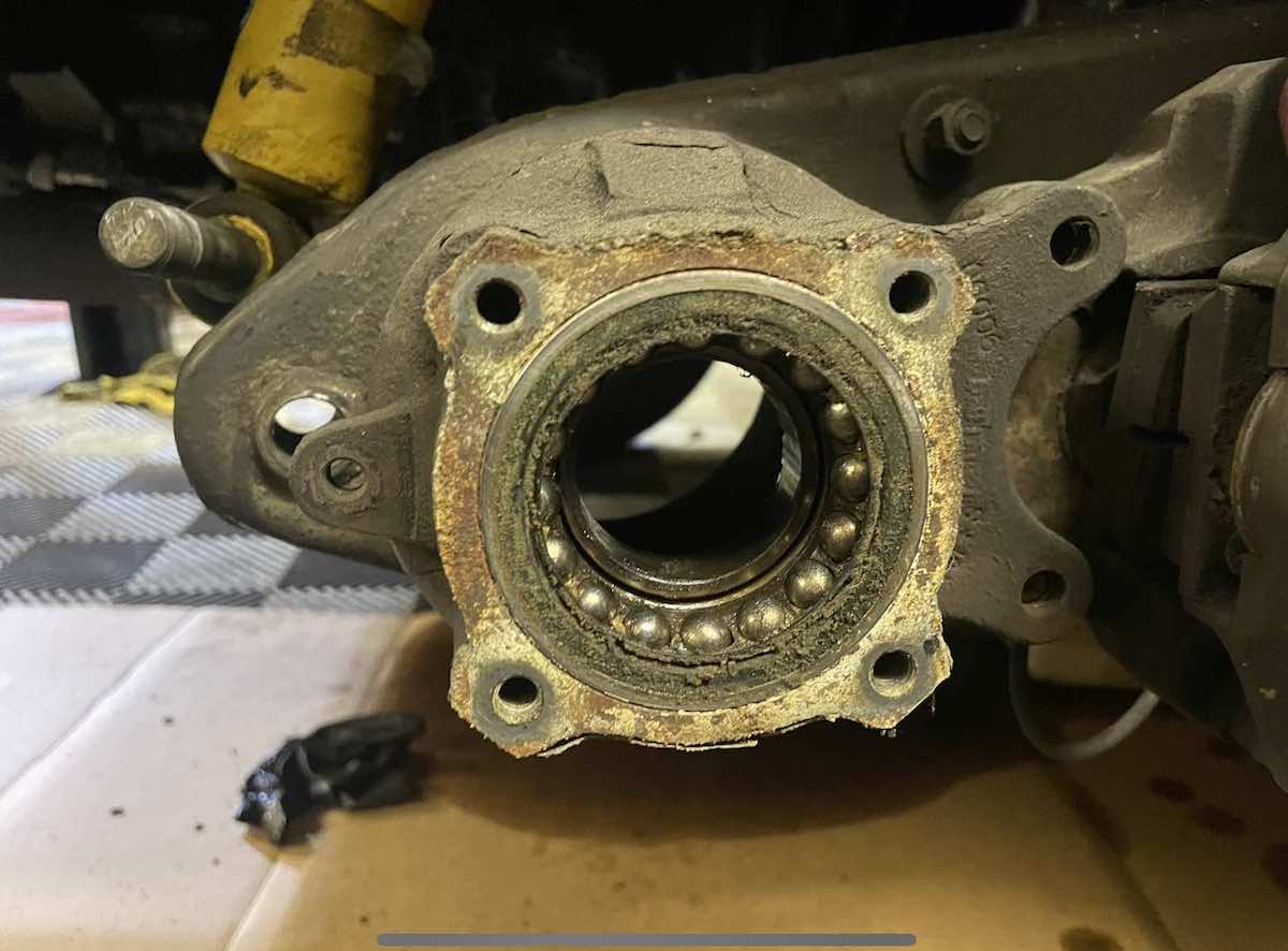

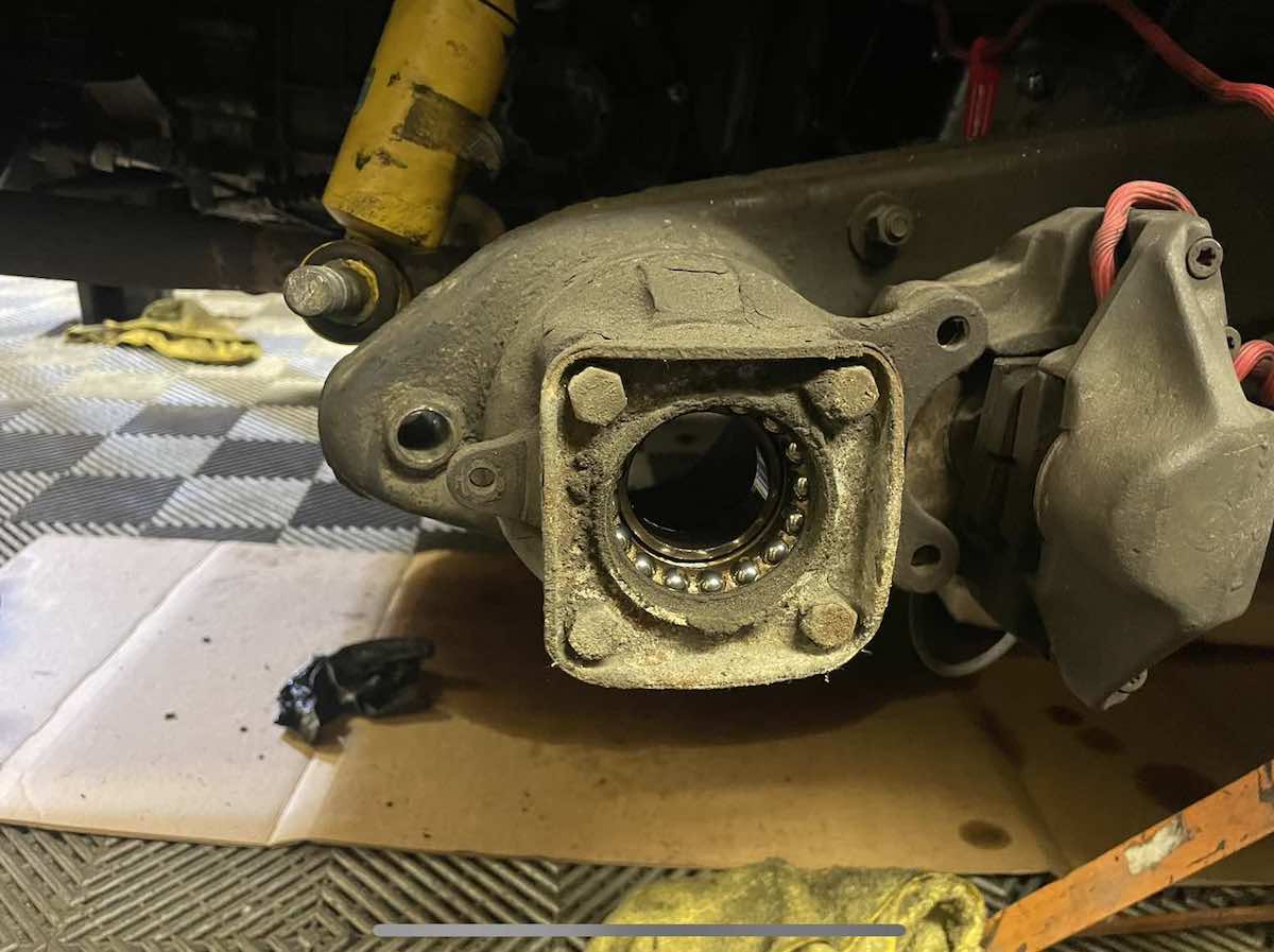

As we dug in further it became apparent that this bearing hadn't been touched in a while and clearly needed replacing.
I managed to keep my apprentice interest long enough to help remove the bearing retaining plate, then he darted back inside to the comfort of the air conditioning.
Check out that filth and grime...

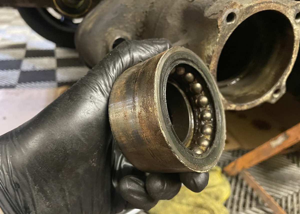

Not sure how long this bearing has been in there, but it wouldn't surprise me if it dated back to 1970.
After spending a couple of nights nestled between some frozen chicken breasts and what was left of the ice cream sandwiches, I rescued the new bearing from the freezer and popped it into the cleaned-up bearing housing.
You'll have to use your imagination to visualize how everything else went back together. Rest assured it all went back together with relative ease.
