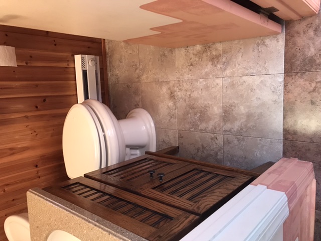

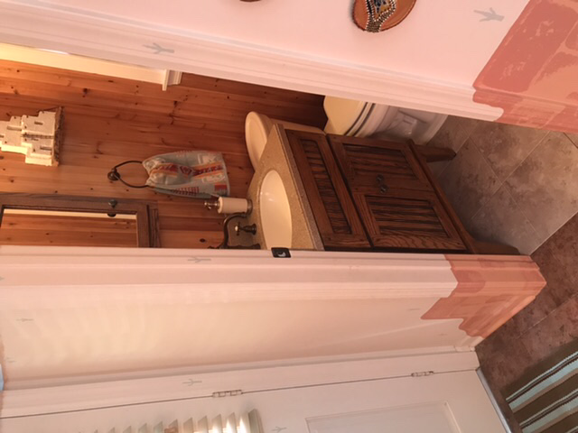

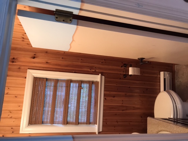

Done! Trial testing completed!
The 914 repair experience of strong core and ability to attach things blindly, usually with just fingertips, came in handy.
Relax and cleanup this afternoon then back to swapping out AAR tomorrow.
