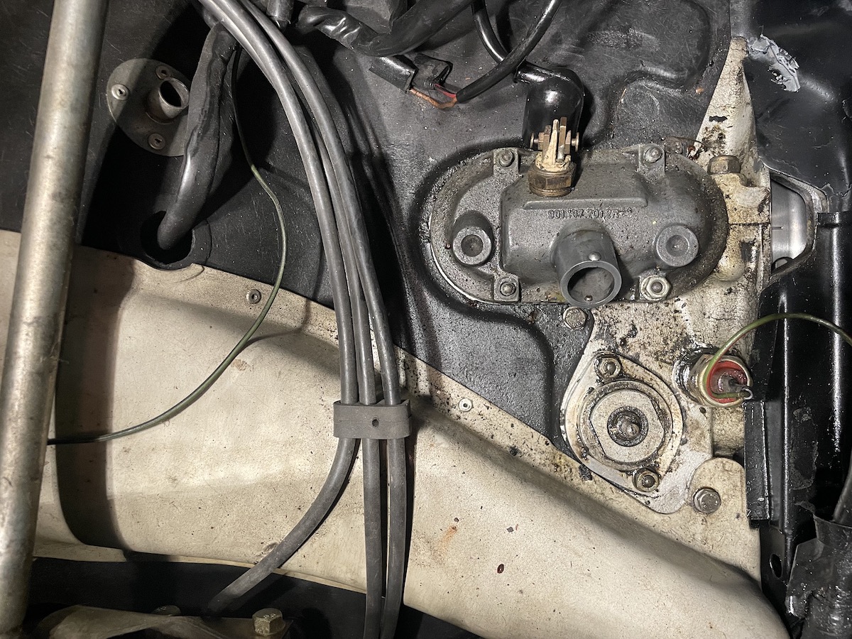

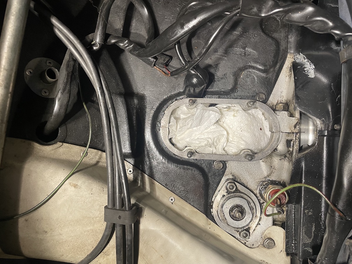

On to the next project on my list, the "triangle of death." It's such an ominous name, but rest assured I successfully took on the triangle and came out completely unscathed.
Here is the triangle pre-repairs. Most probably know, but it consists of well the triangle formed between the oil breather housing, the thermostat and the oil pressure switch. Some if not all tend to leak oil at some point so I figured I'd tackle them all.

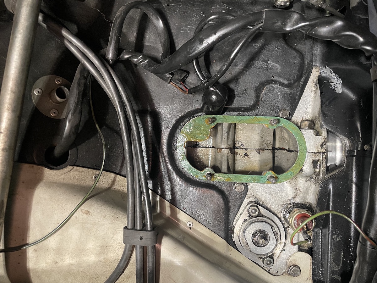

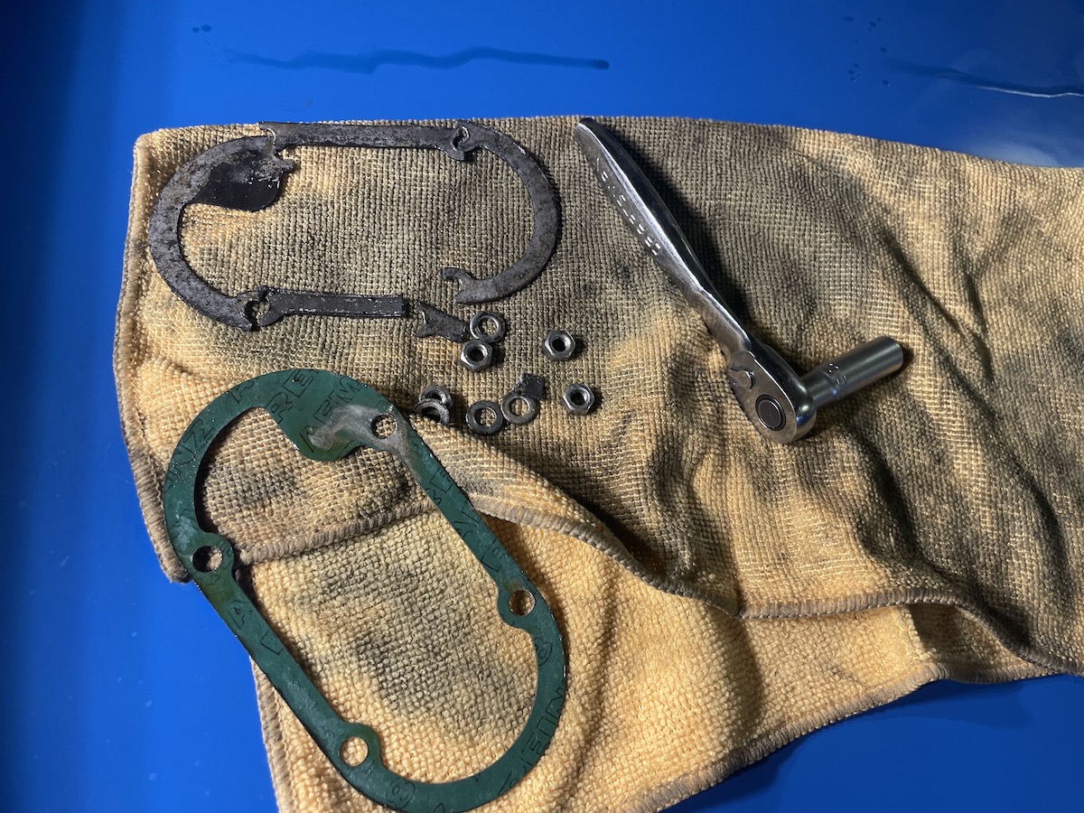

The breather housing was first on my list.
It, like the two other corners of the triangle, was seeping a bit. I'm sure having two gaskets hidden under the cover didn't help. I'm trying to figure out who the prior guy was who slapped one gasket over the top of another? Oh yeah, that was me. Probably a good 12 years ago. To my (dis)credit, the gasket under the green one was silver and properly affixed to the engine case.
With the mating surfaces cleaned up, new gasket affixed and breather cover re-fastneed I moved on to my next project...
...grilling dinner. A guy has to eat, right?

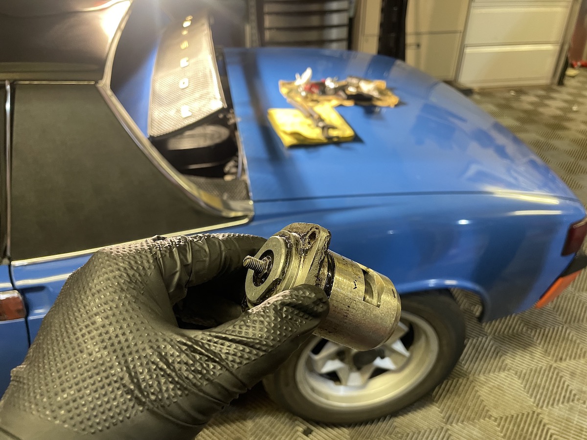

I then moved on to replacing the oil pressure switch. It was a quick fix, however finding the correct aluminum washer that mounts between the switch adapter fitting and the case was a bit of a scavenger hunt. Following visits to the local hardware store and two auto parts stores, I had what I needed and checked the pressure switch off of my list.
I'm continually amused when I walk into my FLAPS and they ask what I'm looking for. My usual response is, "It doesn't matter, you're not going to have it." Lately it's been trips like this for crush washers and other hardware. Every now and then I find a helpful parts rep who saves the day. I found that guy this time around. That's a win in my book.

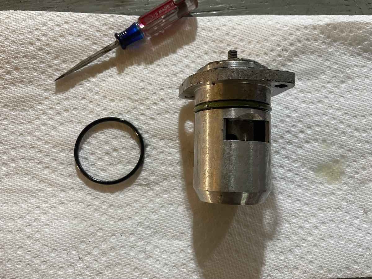

The final corner of the triangle was the thermostat o-ring. This was another easy job. Out comes the t-stat.
Off with the old seal and on with the new one.
I reinstalled the thermostat then got the triangle of death cleaned up nice and pretty. I've filed paperwork to rename the area the triangle of cleanliness, but I know the clock is ticking until it again gets dirty.

porschetub
post Aug 18 2023, 02:53 PM
Posts: 4,980
Joined: 25-July 15
From: New Zealand
Member No.: 18,995
QUOTE(vintage914racer @ Aug 19 2023, 05:41 AM) *
The next day I treated myself to a drive to work in the 914 and took the long way home.
All told I added a good 50 miles to the odometer. The good news? No more triangle of death leaks. The bad news? I found more leaks.
While I replaced my lower valve covers with 930 covers and new gaskets (and failed to document it here), I didn't replace the uppers. Would you believe that they too seem to be leaking? Let just say I was a bit surprised at the leaks. But that's what happens when you clean up a mess. You quickly notice when a new mess is made.
I had a leak @ the breather cover for similar reason,when I removed it the gasket was way too thick compared to the VR replacement and was way over tightened,I had a section of sheet glass I had used to reface my valve covers and ran the cover over on that....it was twisted and took a bit to get right.
I have a leak @ my oil pressure sensor that i'am going to attend to ,its only small but enough to piss me off .
Leak chasing and repair IMO is part of the came with these engines.
Keep up the good work,cheers.
