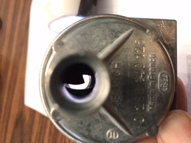

Ok, new larger AC358 (BMW) Bosch 125 AAR installed. Runs just like the borrowed unit; definitely takes a bit longer to settle down to a nice 1000 rpm idle than the stock unit do to larger opening.
The new one came with its room temp 74F opening a bit larger than the borrowed unit so adjusted it abut 10% more closed to be the same as the borrowed unit. See pic:
Now of course another issue has cropped up now that I can drive it for longer runs where the engine now gets to full temp. At full temp, Runs fine at cruise and acceleration but Cuts out at stop lights or other low rpm; restarts just fine. But that’s another thread after I investigate a bit…

StarBear   Ok, new larger AC358 (BMW) Bosch 125 AAR installed...   Aug 19 2023, 03:58 PM
