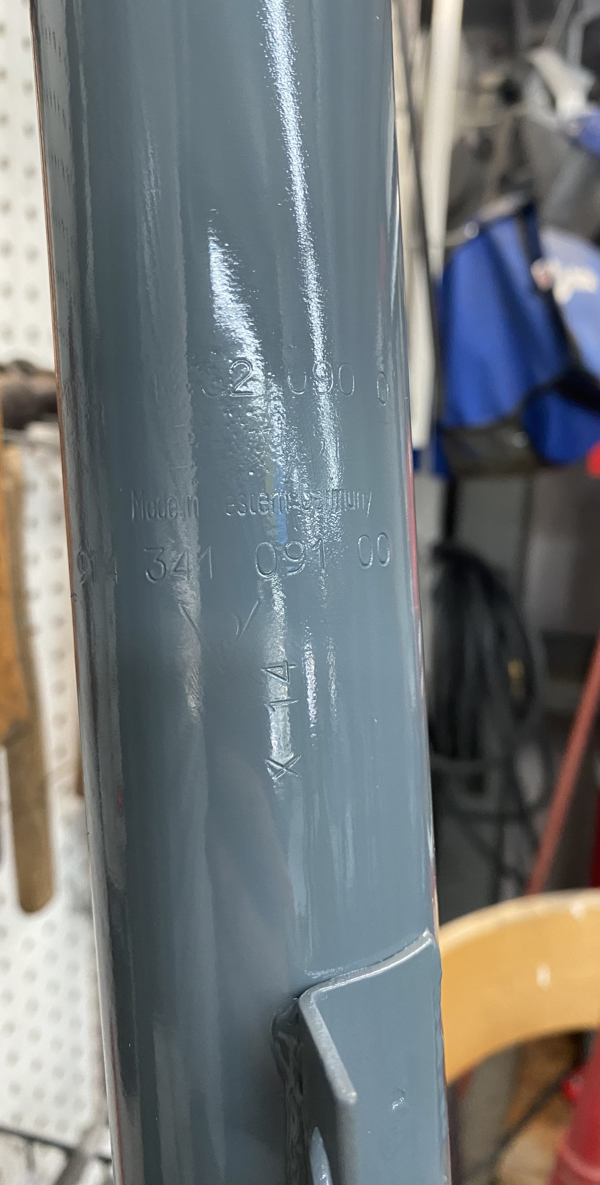

Original 914-6 front strut, part numbers are for 6 only and were Boge Grey
NOS and restored for comparison Attached ImageAttached Image
