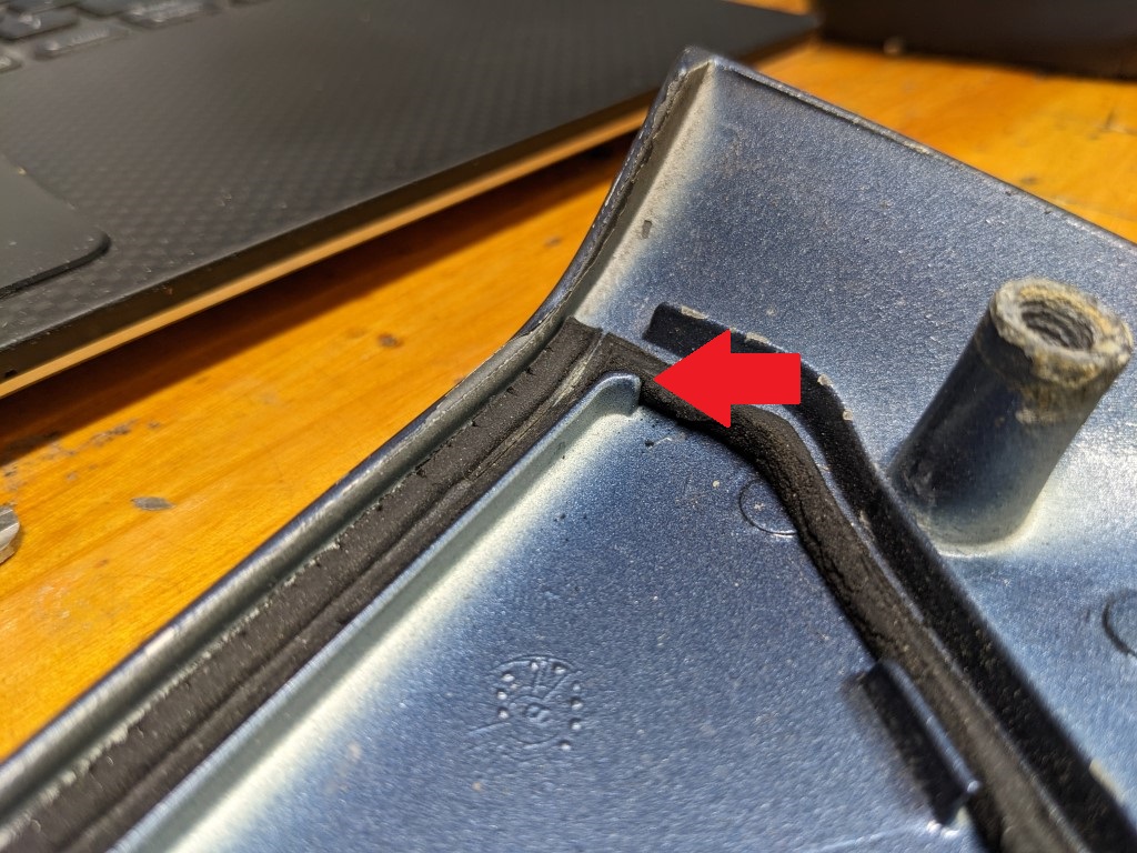

As I was preparing to ship the LEDs back to the original 944 owner I noticed the plastic lens fixture didn't sit flush.
On inspection I realized this ridge on the exterior piece was interfering with my supports.
So I had to trim the edges of the supports to allow for the ridge. All is well now.

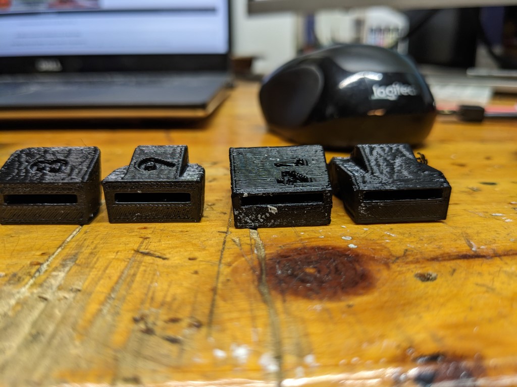

Spoke   Boards are in. Designed some clips to hold the...   May 3 2023, 11:05 AM

Spoke   The boards slide into the spacers. The boards...   Sep 1 2023, 08:08 PM
