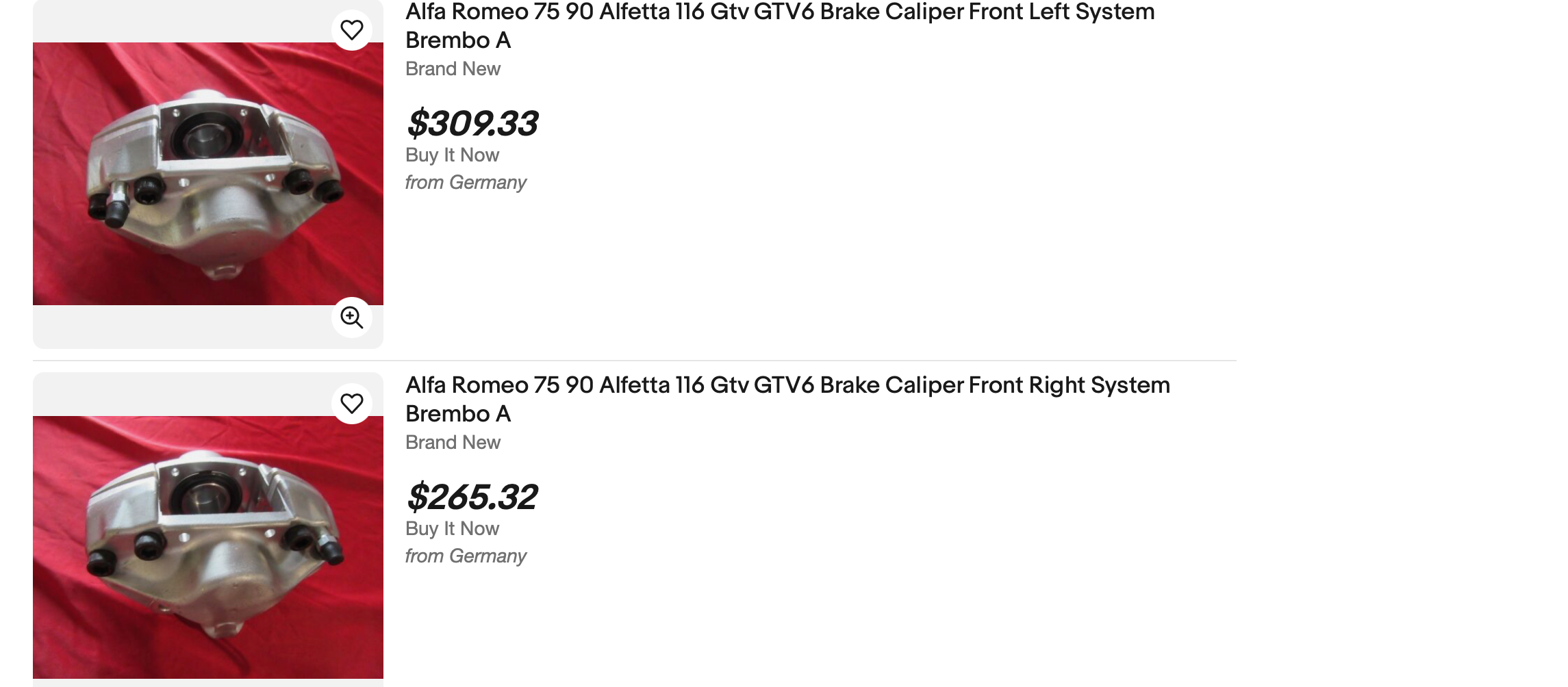

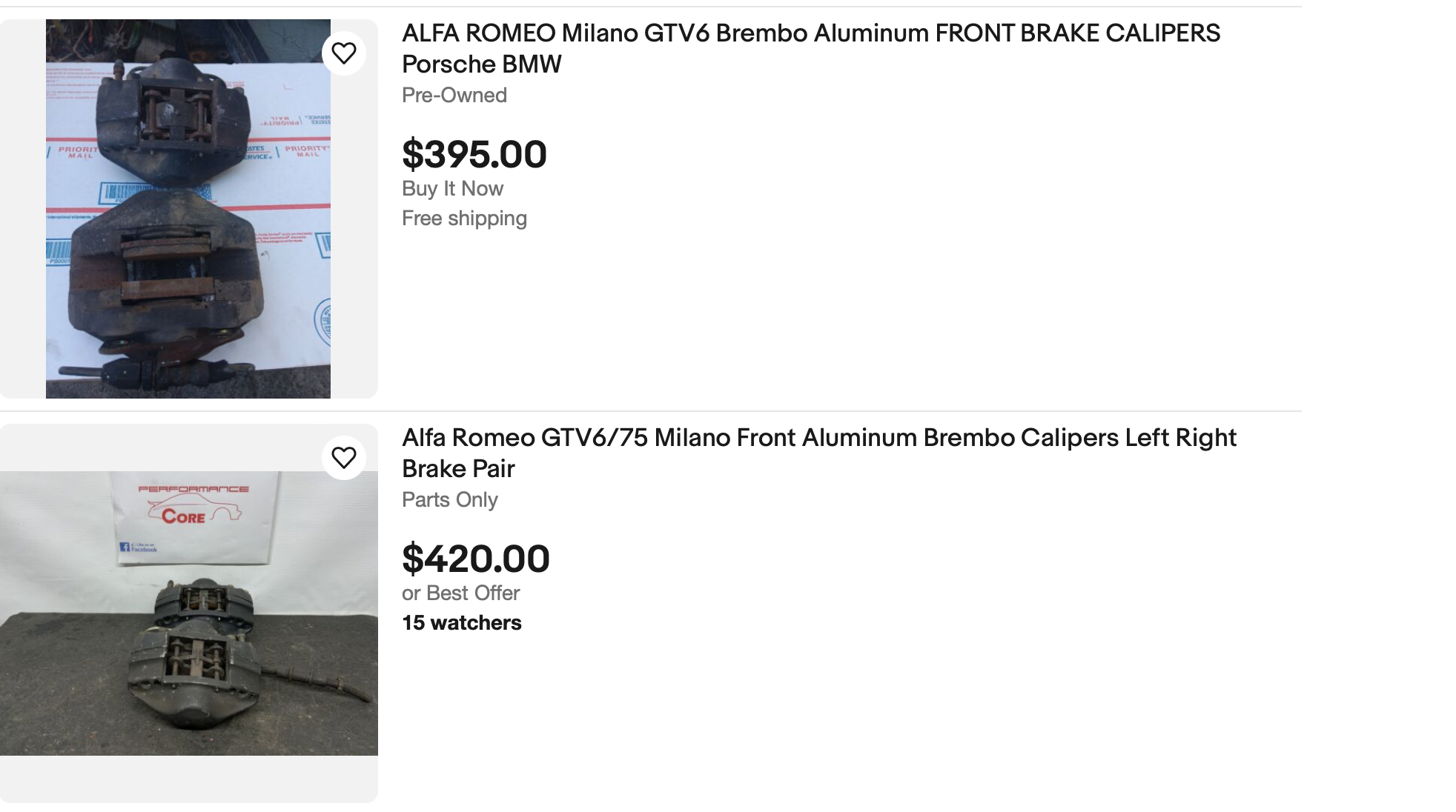

What Alfa Romeo alloy caliper (from what model car) is suitable to replace 3"
front calipers ?
AND...is it suitable for use on the rear of a 914 with 911 vented rotors ? provided
911 emergency brakes are adapted.
TIA

Alfa like this?
I was an early adopter. Eric Shea suggested them and I obviously bit. My rears are the alloy collaborations between 914Rubber and PMB. They are unobtanium now.

They are on eBay and other sites. Now granted, they aren't cheap to rebuild, especially if you want the polished silver finish but similar to 911S calipers, that's just the way it is.
You can also buy new reproductions.
