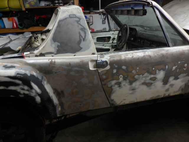

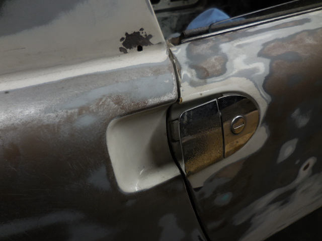

Alright alright getting back into working on the 914 after a long hiatus and some serious life changes that have freed up some time for me. That being said I'm excited to get back to working on her and posting on here.
So after doing welding I must've installed the chassis braces incorrectly or something because both doors are quite tight but the passenger door is the sticky wicket. Is there anything I can do to expand it to give the doors some more space? I mean it will work in the current state but certainly not ideal.

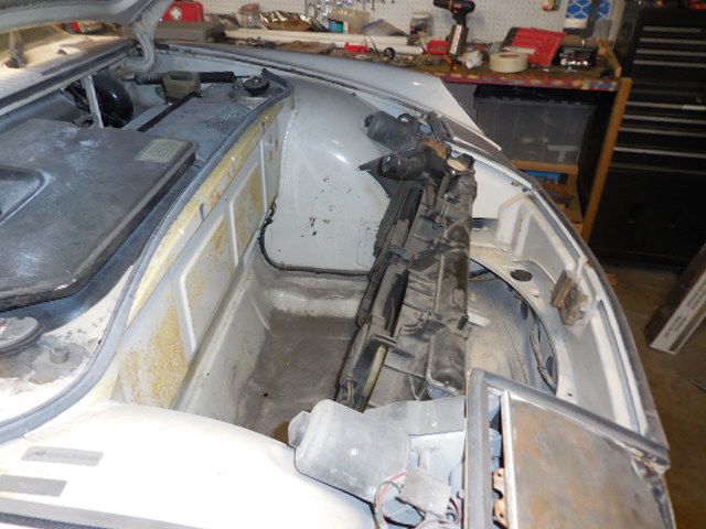

Second, for the engine bay Gint stopped by today and gave me some pointers and he mentioned to use lizard skin. Ive seen other folks using the spray in bedliner raptor stuff. Has anyone used either or something else and have any recommendations?
Third I am going to start making a bracket to install the radiator. Is there any issue with having it angled in here?

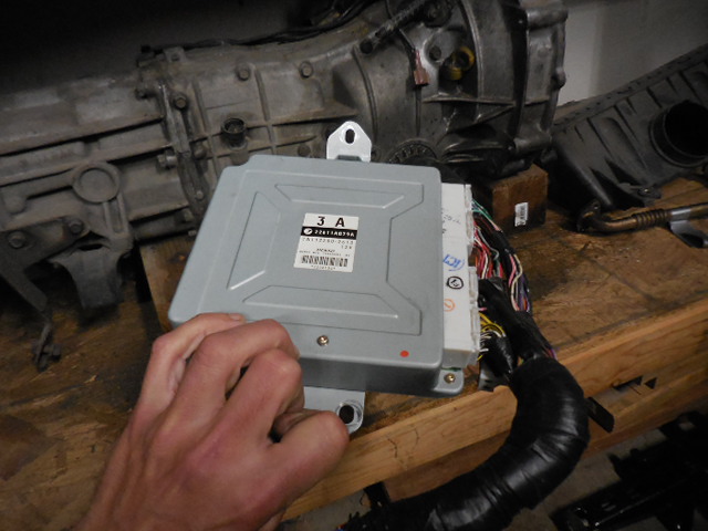

Another item that im quite confused on is wiring. I have the ECU from the donor car (LL bean outback) but not sure exactly how to go about pairing it to the 914. What is the process? Do i have to pull everything out and lay it out then reinstall the wires or should i just leave all the wires in place and label them? Here is a photo of the ECU i pulled out of the car.

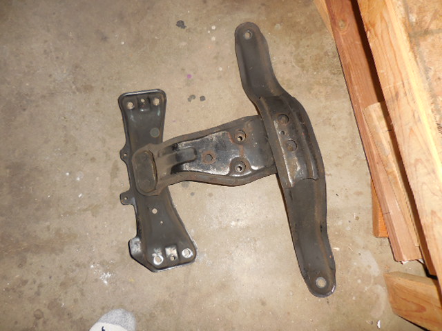

brettrarnold   I recently purchased an EZ30D engine and transmiss...   Jan 28 2018, 02:58 PM
hockeymutt   Yea I'm in the same boat! I need a cradle ...   Jan 28 2018, 05:05 PM
mb911   I would love make these but never was able to get ...   Jan 28 2018, 08:08 PM
rnellums   Brett, don't rebuild the motor, is cheaper and...   Jan 28 2018, 09:14 PM
brettrarnold   Sweet i will make myself available if you get a ni...   Jan 28 2018, 11:08 PM
rnellums   Stick with the hydraulic clutch. After looking bac...   Jan 28 2018, 09:18 PM
brettrarnold   Junkyard find or should i buy something newer? Wo...   Jan 28 2018, 11:11 PM
rnellums   Junkyard find or should i buy something newer? W...   Jan 29 2018, 07:13 AM
brettrarnold   upullandpay near washington and 70th. saw this o...   Jan 29 2018, 08:45 AM
