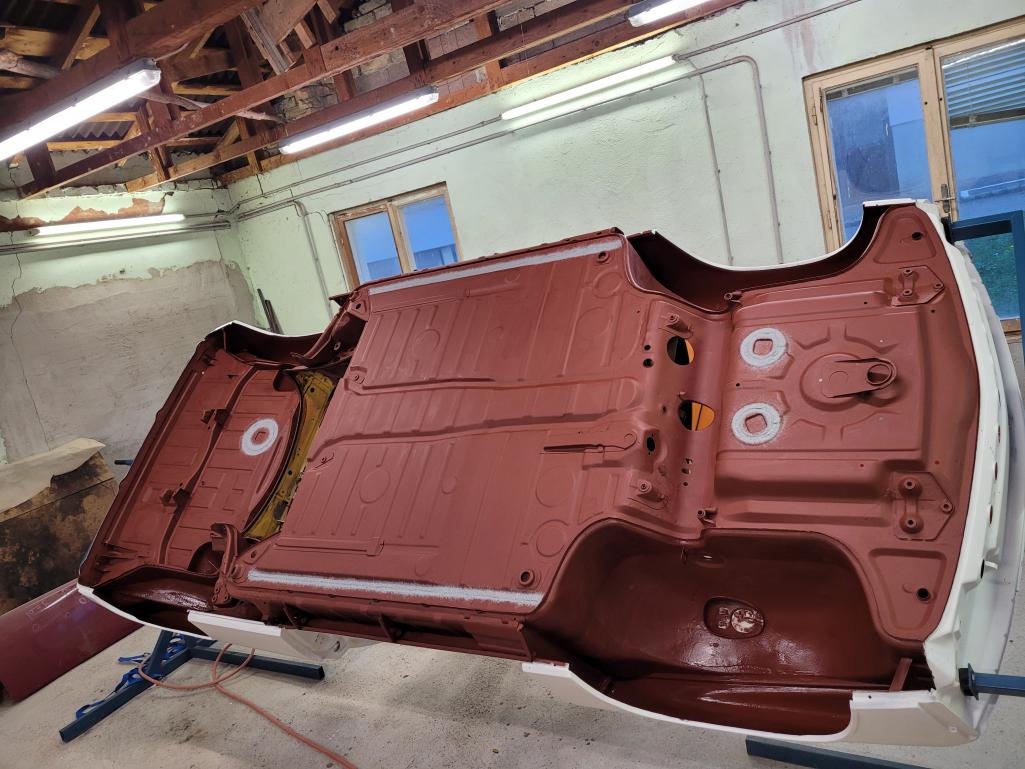

It looks like the body of my car is now ready for the paint job. After spending ancountable hours of body work I'm proud to show you how is solved all the body work issues.
The decision to rent the car bench from the germany 914-6 club was one of the best decisions I made. I learned a lot about body work and bought many tools to work like a car shop however it wasn't a simple job. After all my experiences I thing a 914 body is hard to repair!
But now I'm glad to present the result.Attached Image

914Gelb   All the pain job you see I made by my own, covers ...   Sep 27 2023, 07:29 AM
