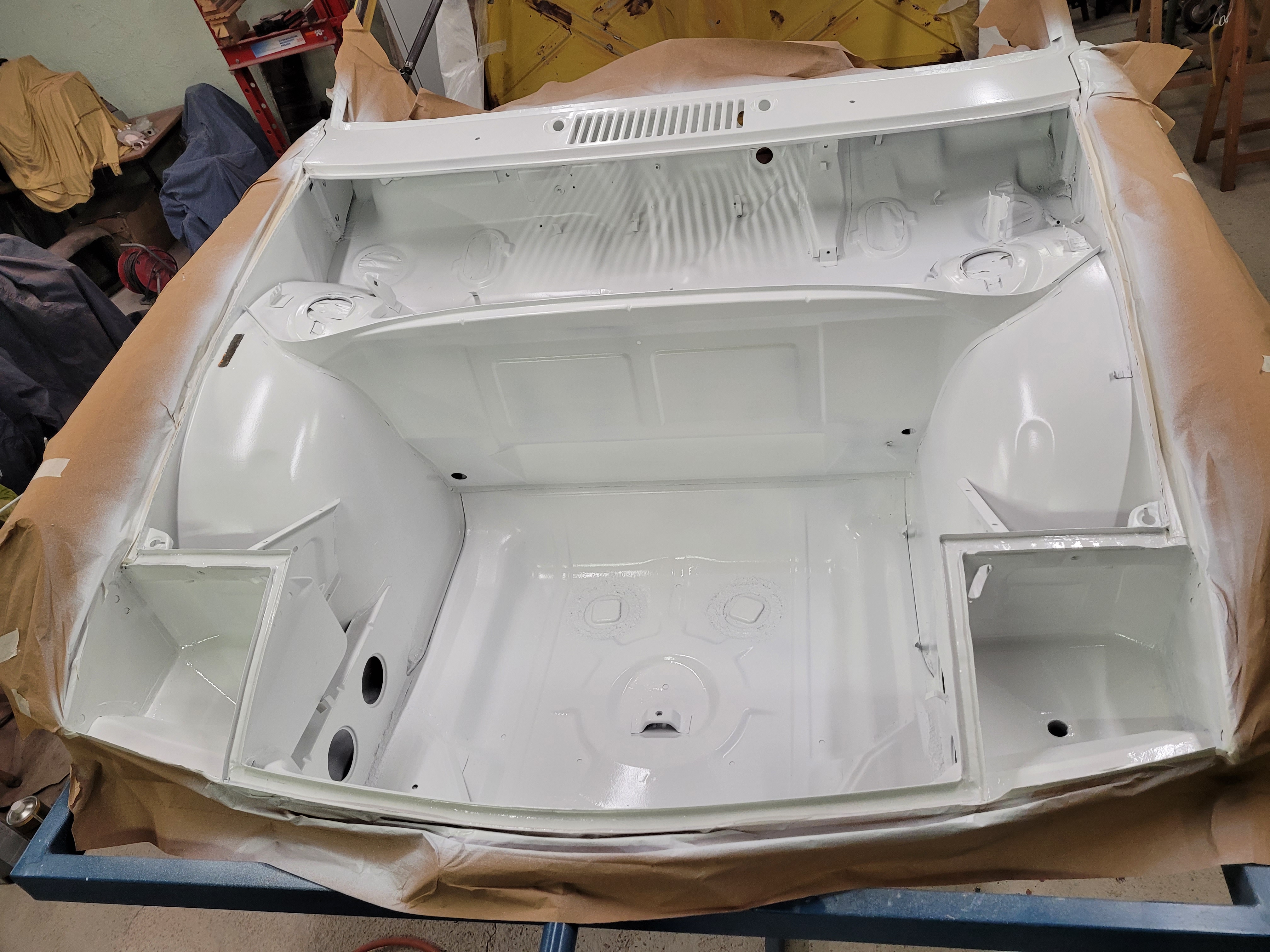

914Gelb   All the pain job you see I made by my own, covers ...   Sep 27 2023, 07:29 AM
