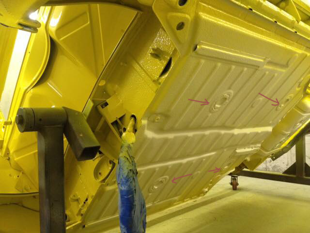

QUOTE(914Gelb @ Sep 27 2023, 06:14 AM) *
You are doing a super job on your 6 but I would like to make a suggestion, cut the pan and put the cover plates back the way it was from the factory. Your not hiding anything, and it looks like the pans where on the car as it came new. Just a small point. You can reuse your covers or get some used ones or you may find some new ones.
That is what I did on my 6
Best Bob B
