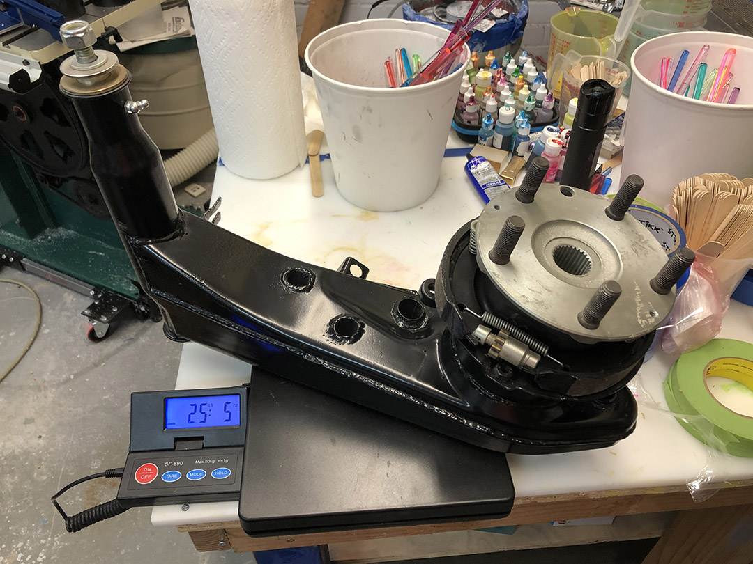

@rgalla9146 What can I do to help you brother, pictures of the bottom of my 6 and a
picture of the vented rear 914-6 caliper. My cables do not touch the Heat Exchangers. I did have eric set up a rear trailing arm with tube reinforcements and Elephant bushing for my V8 car that we changed direction on That was going to use Boxster non S rear with Rich Johnston adapters and vented disks
Best Bob B
