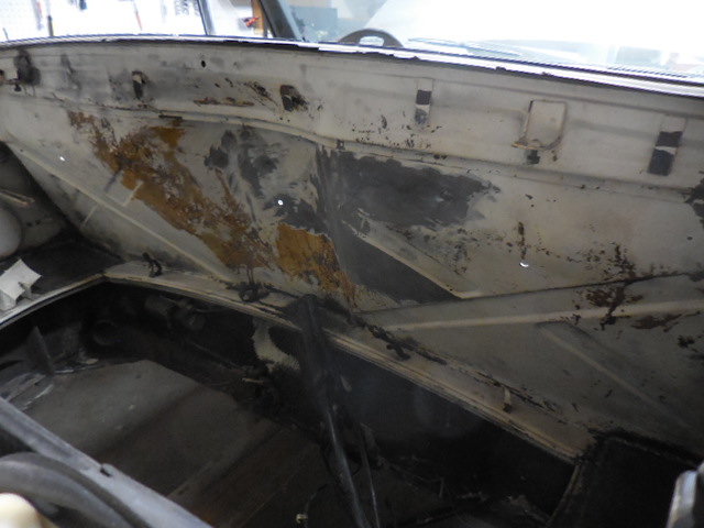

Step 1 (Complete) was to remove the engine and assess the frame rust situation. Never having removed an engine from a car, this was an extremely daunting task. The steps listed in Pelican Parts tutorial - 914 Engine Removal Made Easy is by far the most difficult thing I have done to a vehicle thus far. Hell I don't even know the difference between a camshaft and a carburetor much less a CV joint or a clutch cable. But after staring at it for about 2 weeks, I decided to just start unhooking shit and labeling. Made a ton of progress and finally got the engine about 95% unhooked. Had a friend come over to help me out and we actually got it out. WOOHOO!!!
Step 2 (Complete) is to strip out all the interior. I ordered chassis braces and other misc items from Tangerine racing and am still in the process of identifying all the rust areas that need repair.

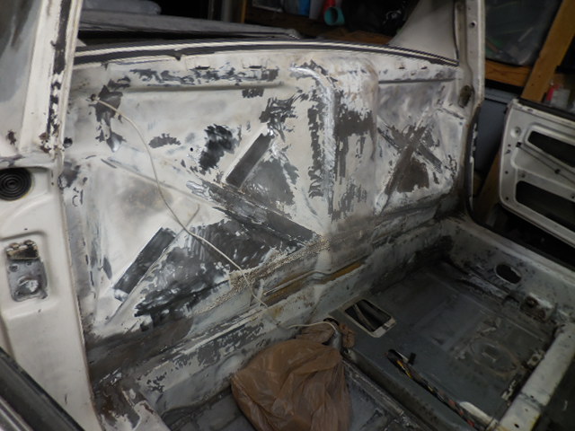

Okay i have a couple of questions before just attacking this with the angle grinder.
I am planning to spray on bedliner in the engine compartment. Should i be grinding all of that down to bare metal as well? Do i need to spray Primer on everything before spraying on the bedliner?
How much grinding on the rear metal behind the seat? Should i be getting it all down to bare metal all over on the inside?? Does the bedliner really help with sound dampening?
