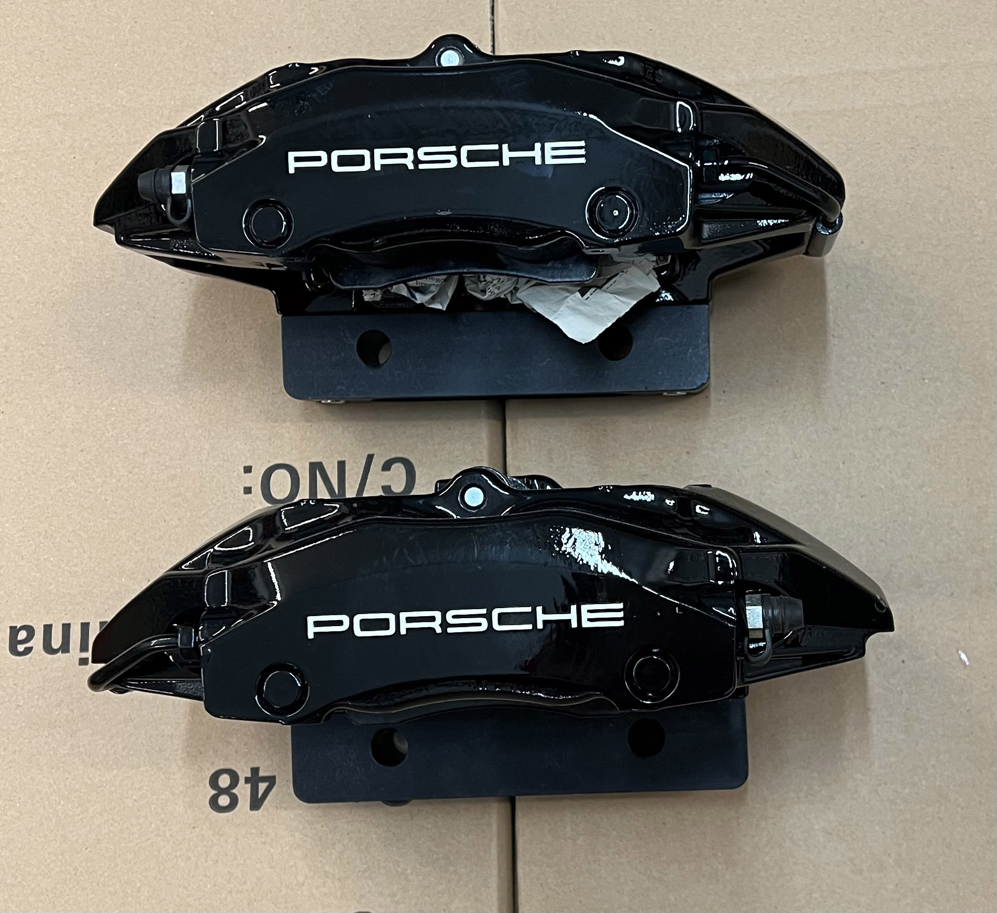

What Alfa Romeo alloy caliper (from what model car) is suitable to replace 3"
front calipers ?
AND...is it suitable for use on the rear of a 914 with 911 vented rotors ? provided
911 emergency brakes are adapted.
TIA

Hi Rory
This is what I think are the fronts with the RJ adapters. Not sure what is different in size, but you can get an idea of the piston size. I went over this with Eric S in Jan or this year.
I have a lot of pictures. I have a set of rear calipers from my 86 Carrera (that car is now with Dax in Belgium with PMB rebuilt calipers on it) that need rebuilding that you can have for free. You just pay the shipping. You can have the fronts as well.
Best Bob B
