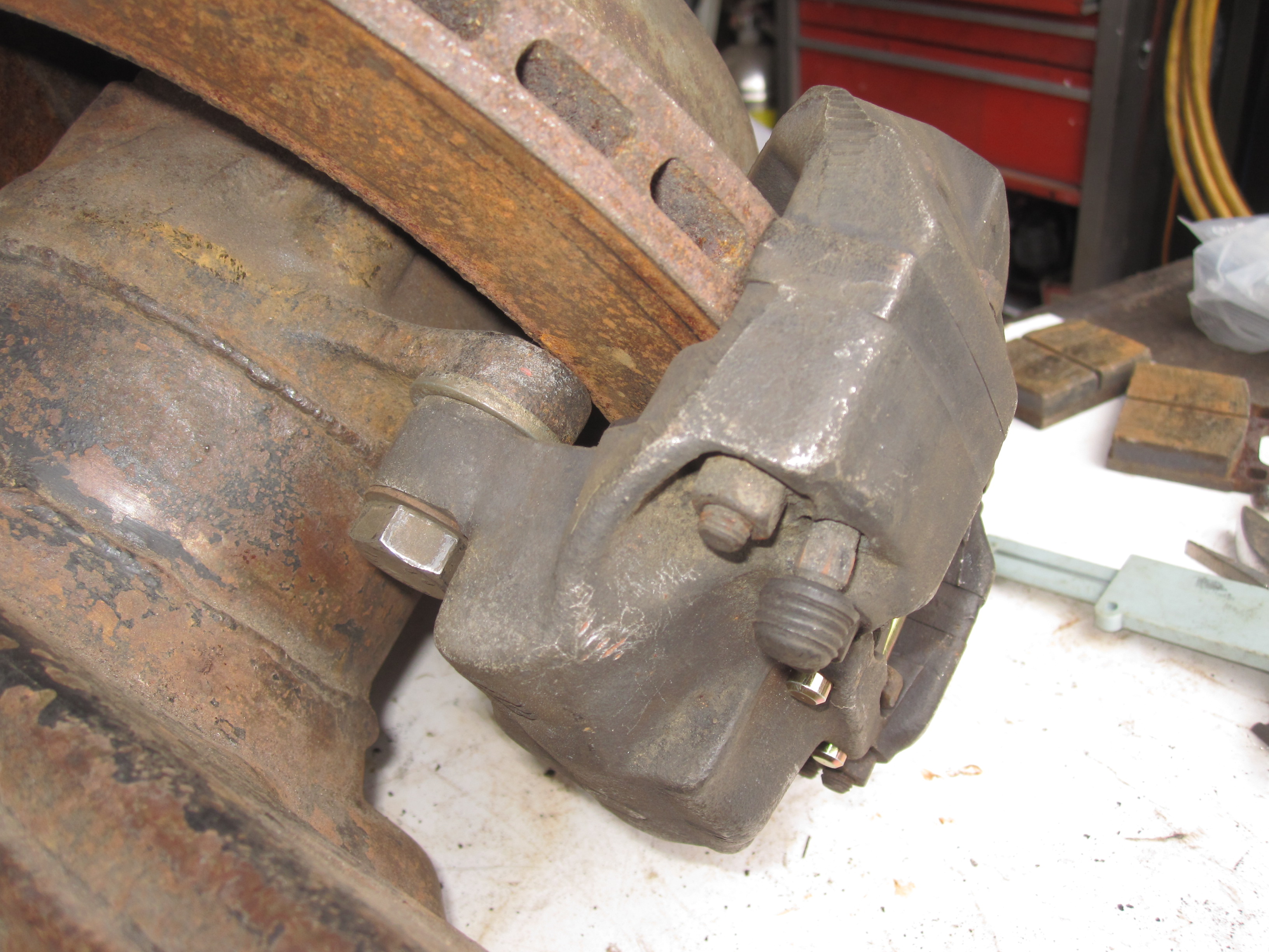

Good update on rear calipers.
I found these among my random collection but have no idea what they are from.
Could be VW, Audi, 356, 911 or ?

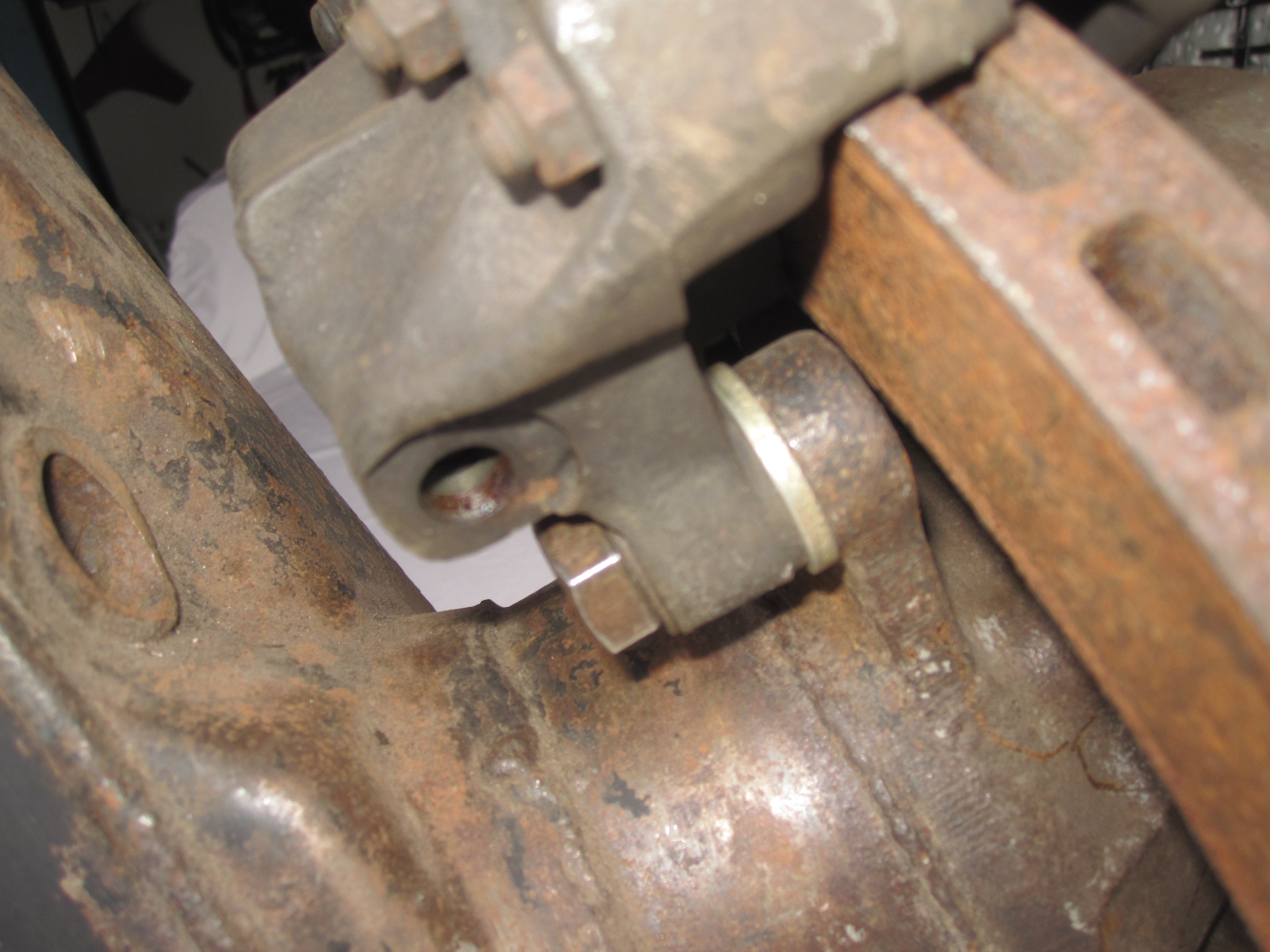

They're ATEs with 38mm pistons and are suitable for vented rotors. The spacers in
them are as manufactured. These are a good match for alloy S fronts.
They mount on our trailing arms and with a fat washer are near perfectly centered.
They are left and right with the bleeder at the top and the hard plumbing to the
bottom. They take 60mm pads, same as 914 6 rears.
I guess no alloy rears for me.
Anyone know what they're from ?

Standard 911 rears from 69-83. The early ones had a machined spacer, later went a cast spacer.
