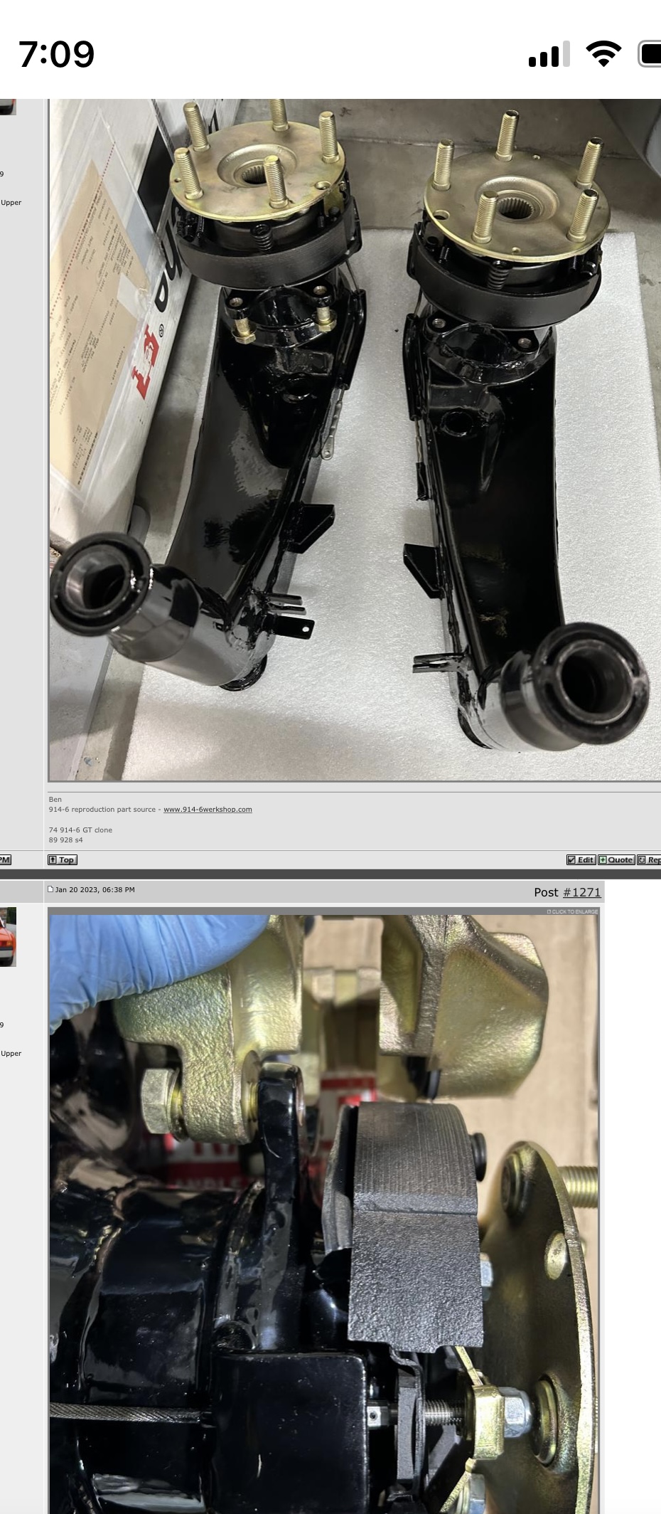

rgalla9146   Next mystery. I've had these 911(what year...   Sep 30 2023, 06:59 PM
mate914   Next mystery. I've had these 911(what yea...   Sep 30 2023, 07:14 PM
mb911   Next mystery. I've had these 911(what yea...   Oct 1 2023, 06:20 AM
mepstein   Next mystery. I've had these 911(what ye...   Oct 1 2023, 07:00 AM
mb911   [quote name='mb911' post='3105249' date='Oct 1 20...   Oct 1 2023, 06:07 PM
rgalla9146   Next mystery. I've had these 911(what ye...   Oct 1 2023, 09:38 AM
Luke M   [quote name='mb911' post='3105249' date='Oct 1 20...   Oct 2 2023, 07:54 AM
mepstein   @MB911 Ben did the conversion recently and needed...   Sep 30 2023, 07:02 PM
mate914   Those brake shoes look like the right parts. The c...   Sep 30 2023, 07:17 PM
mate914   Am I going to have to take my brakes apart and tak...   Oct 1 2023, 12:00 PM
rgalla9146   Am I going to have to take my brakes apart and ta...   Oct 1 2023, 12:21 PM
mb911   Here is my set up done.   Oct 1 2023, 06:13 PM
Luke M   Here's the e-brake pad and hardware info. The ...   Oct 2 2023, 09:46 AM
