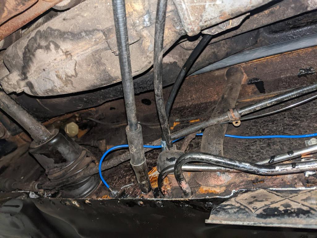

What do you all think of this location for mounting my new pump in the front?
Besides space, I have some other goals:
1. Avoiding mounting on any sheet metal shared with the passenger compartment.
2. As much protection as possible.
3. Short fuel line runs between the tank, filter, pump, and hard lines.
4. Access to the lines without pulling the tank.
5. Access to the pump without pulling the tank.
My proposed location probably does not satisfy goal 5 (maybe), but otherwise I like it.

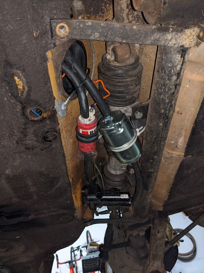

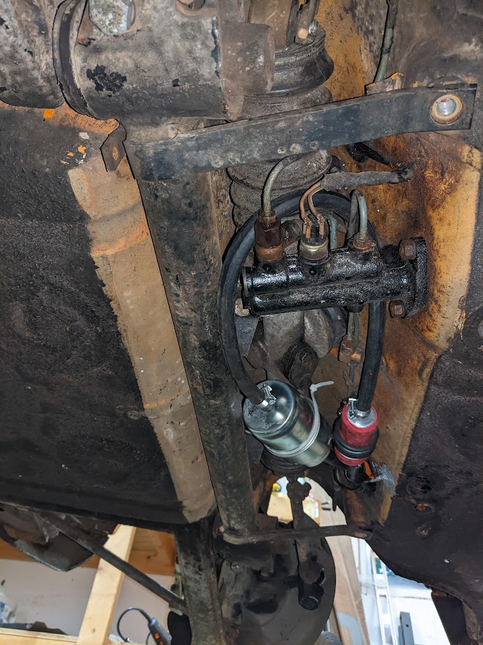

This thread is what comes up for pump relocation but I haven't found many examples of with the steering rack. So here is:
Got through this in a day. Only need one wire if you make a good ground. The filter is pretty big and is a little pressed in with the panel.
I put holes for the wire just big enough to also put in some old washer tubing as a type of grommet/protection going through the sheet metal.
