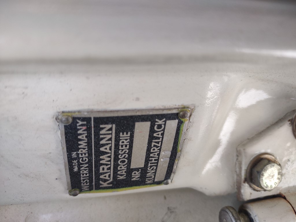

Just a related side note...
I took a picture of the body tag on the Sounato GT at Rennsport.
It doesn't have a number on it, just the paint code.
"Curiouser and curiouser!" - Alice

Not sure Jeff, I don't plan to peel away the sail vinyl, etc to find out; but both cars sent to Sonauto Paris, France >> our Chassis #1020 (LM24 car) and Chassis #1017 (J. Duvall Daytona car) both arrived in light ivory. I did see some pics somewhere online of #40 in an assembly area and thought I saw a bit of red near the targa sails (IMG:style_emoticons/default/confused24.gif)
(IMG:style_emoticons/default/number40_914.jpg)
