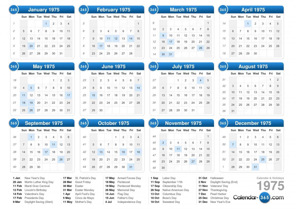

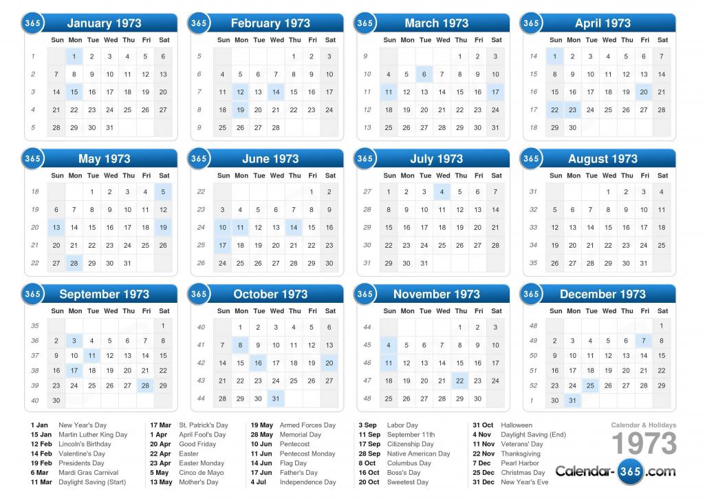

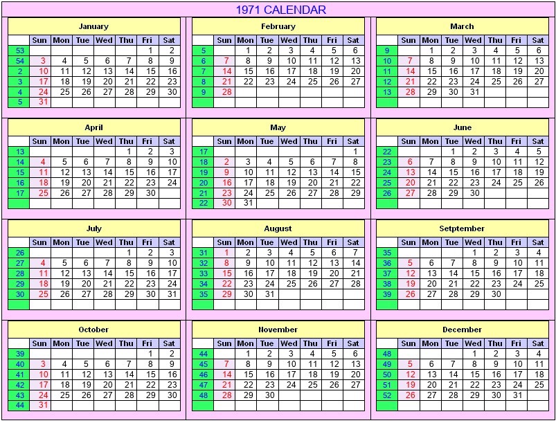

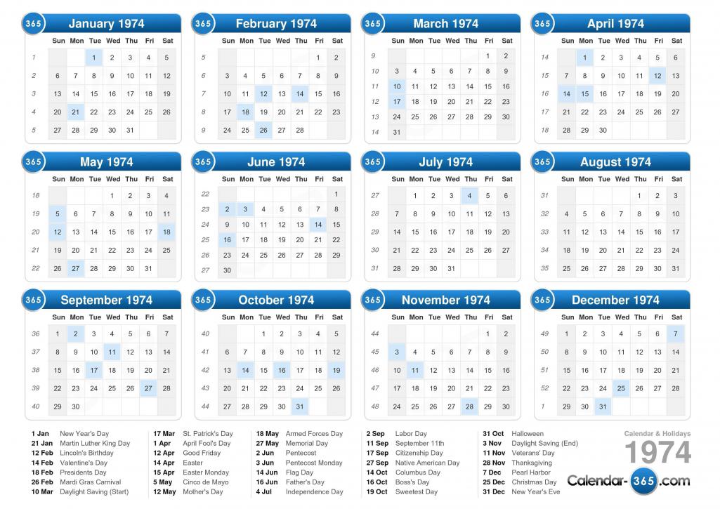

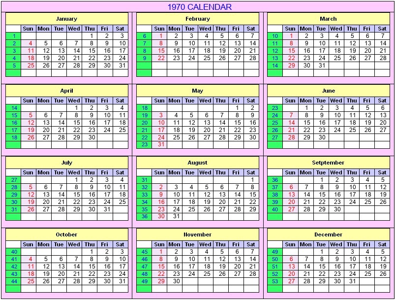

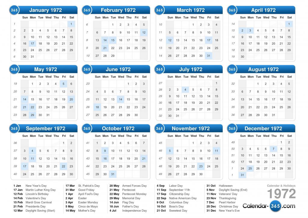

76-914   Let me see if I have this correct. If my chassis #...   Oct 3 2023, 10:13 AM
dax1969   Interesting... 3419547 week 34 1974 - august 1 =...   Oct 4 2023, 04:14 AM
