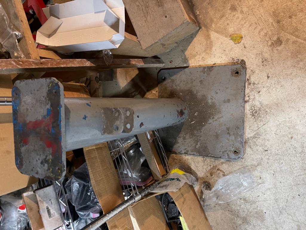

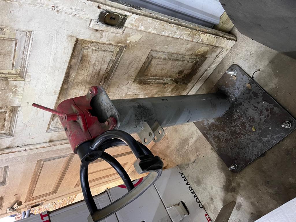

What do y'all use for engine stands??? / bracket??? I like the one from VW alley but can't seem to find any source. Seen some nice ones for $600 bucks but that's not in the budget. The 2 eared ones don't seem they would provide enough support. Thanks for the help.

NARP74   The stand or the cradle or both? There is a guy a...   Oct 11 2023, 11:00 AM
orangecrate   [quote name='NARP74' date='Oct 11 2023...   Oct 11 2023, 12:14 PM
DennisV   [quote name='NARP74' post='3107250' date='Oct 11 ...   Oct 11 2023, 01:02 PM

NARP74   That dimension is for 2 inch schedule 40 pipe that...   Oct 12 2023, 12:07 PM
