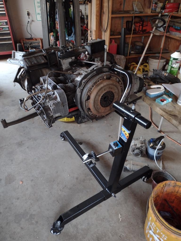

burton73 This is a RAT 2270 fresh Eng. Mark and I are worki... Oct 11 2023, 02:56 PM
