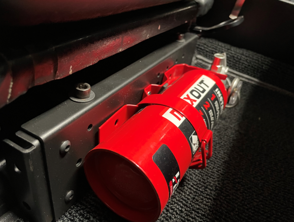

Thank you everyone for sharing their fire extinguisher solutions ..
I was able to mount it under the passenger seat using the universal mount from H3R,
thru an homemade aluminum plate that attaches to the fibergalss seat without having to drill any holes... Attached Image Attached ImageAttached ImageAttached Image

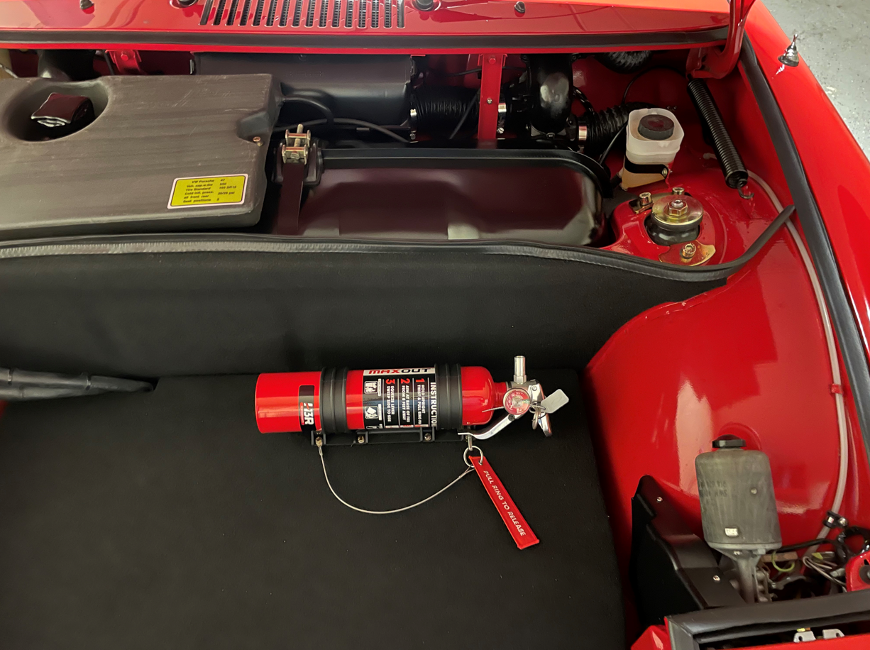

I went with this approach. Used a piece of scrap metal I had lying around as the brace and used the same H3R mount on the passenger seat. Although, I mounted mine vertically. Wanted to keep it tucked in below the seat. Also, put one in the frunk, just in case.
Note: No original parts were harmed during this install
